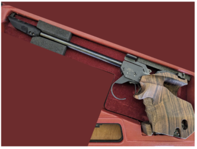

Re: Morini free pistol compensator
Posted: Thu May 16, 2024 6:32 pm
by K38
Perhaps a nylon compensator for the TOZ would be good as well. (Slight begging here :-)

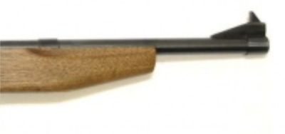

by K38
My TOZ 35M has the front sight that has a replaceable blade but the base is pretty much permanently mounted on the barrel. Does that make sense?
DLB
https://search.app.goo.gl/iqbmLd3
Posted: Sun May 19, 2024 1:18 pm
by LukeP
In my limited experience:
This version has a kind of round strap that comes off.
This one has everything welded to the barrel.

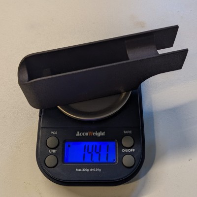

Posted: Fri May 24, 2024 1:36 am
by LukeP
Not much left to lighten up 😅

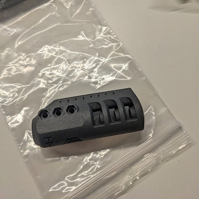

Posted: Mon May 27, 2024 12:20 pm
by LukeP
The TOZ fore hand in the photo is the first prototype, I still have to adjust a few things...
All the compensators, on the other hand, I already have them cyclically available.
Posted: Mon May 27, 2024 4:39 pm
by K38
You have me beat by about 10 grams or so!

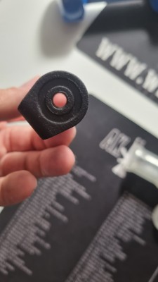

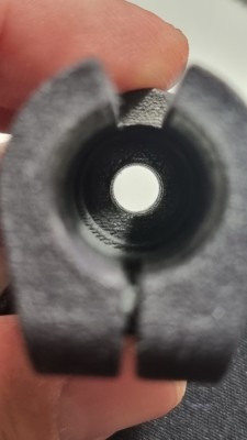

Posted: Thu Jun 06, 2024 1:52 pm
by Azmodan

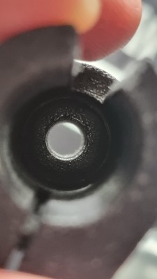

got the compensator for the TOZ-35 and tested it today. the guns jumps less and you can feel that the muzzle is heavier
the first shots were reeeally high. more that a target high. but after ~15 shots, they got back down where they used to be.
i had the impression that the front hole got a bit elongated downwards, but after watching the photos i don;t see it anymore :/
the comp and the muzzle got a little smokey after 35 shots, but no deposits.
