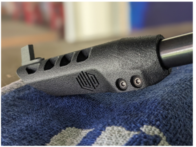

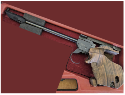

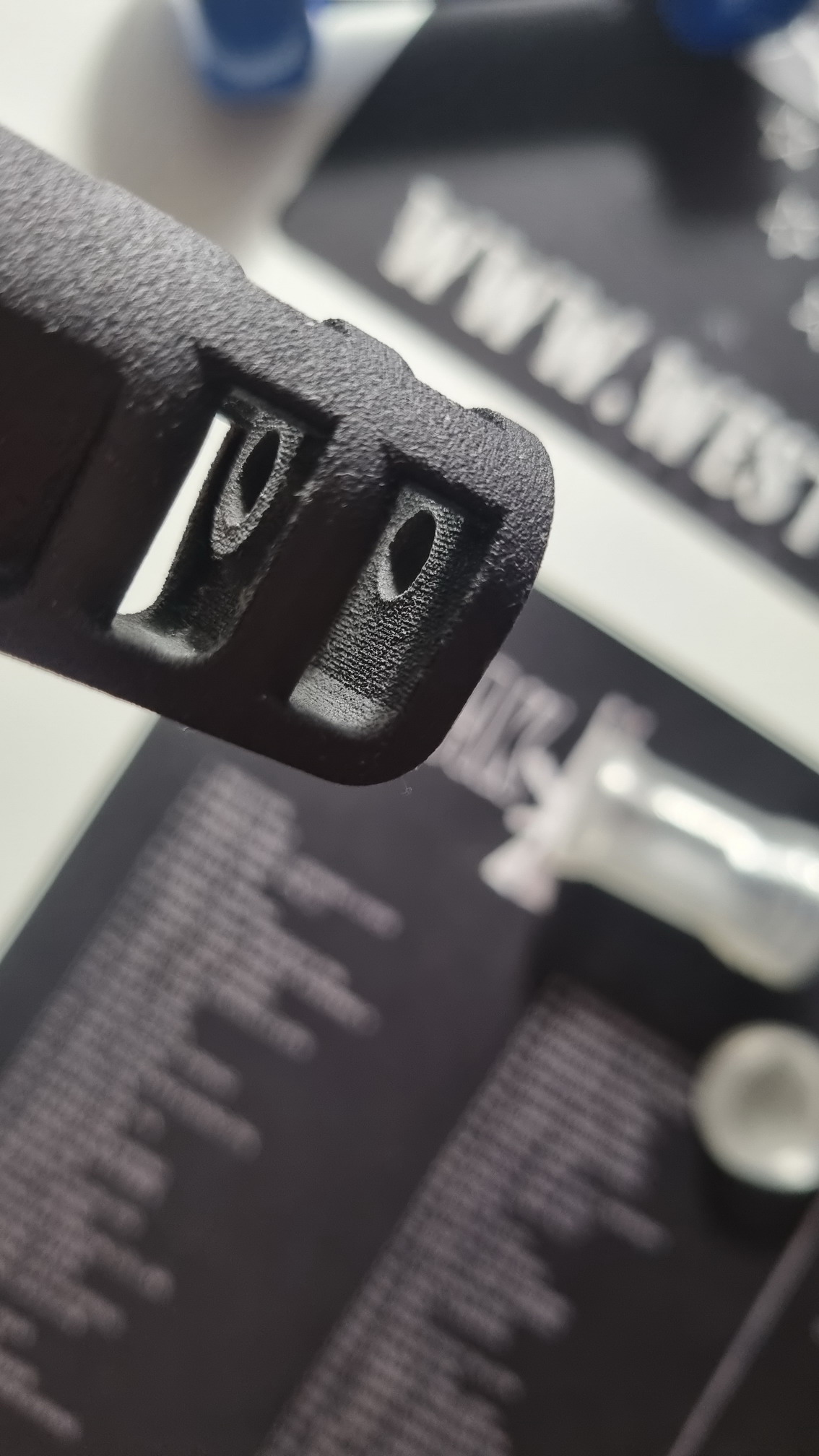

A few years ago, I switched from the Toz to the Morini CM84E.
And I immediately suffered from the different balance.
I found it too heavy at the front: it hurt my elbow after a few shots and I had difficulty holding it up.
The original front sight holder weighs about 70 grams.
So I started experimenting to make a 3D printed sight mount, and trial and error I came up with a fully functional sight holder and compensator.
After the first home-printed prototypes, I switched to a more professional material: sintered nylon, which is strong and heat-resistant.
Extremely light: 25 grams, with a good effect of softening the reaction of the shot.
I have been using it for two years now, in fact there are now five shooters at my range who use it with satisfaction and have not shown any problems.
I made it interchangeable with the original, it uses the standard Morini sights.
I would be happy to show it to you.
Thank you for your attention.

Which version? The one with front sights attached to the barrel or the one where you can slide out the sight holder?

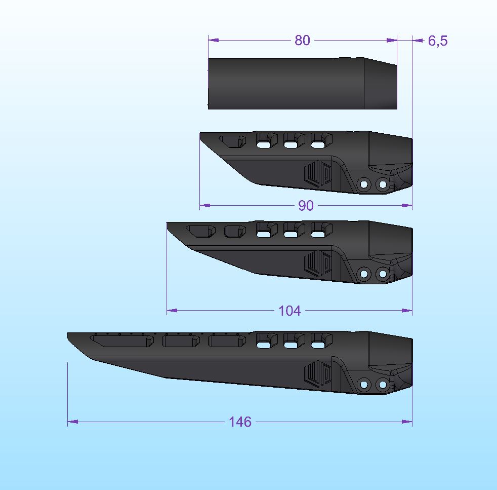

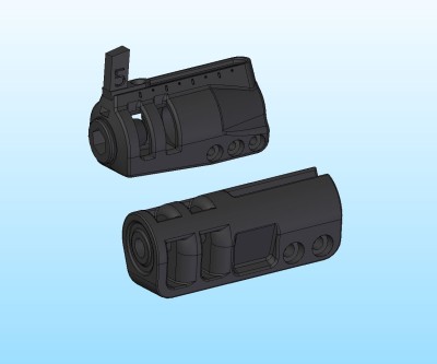

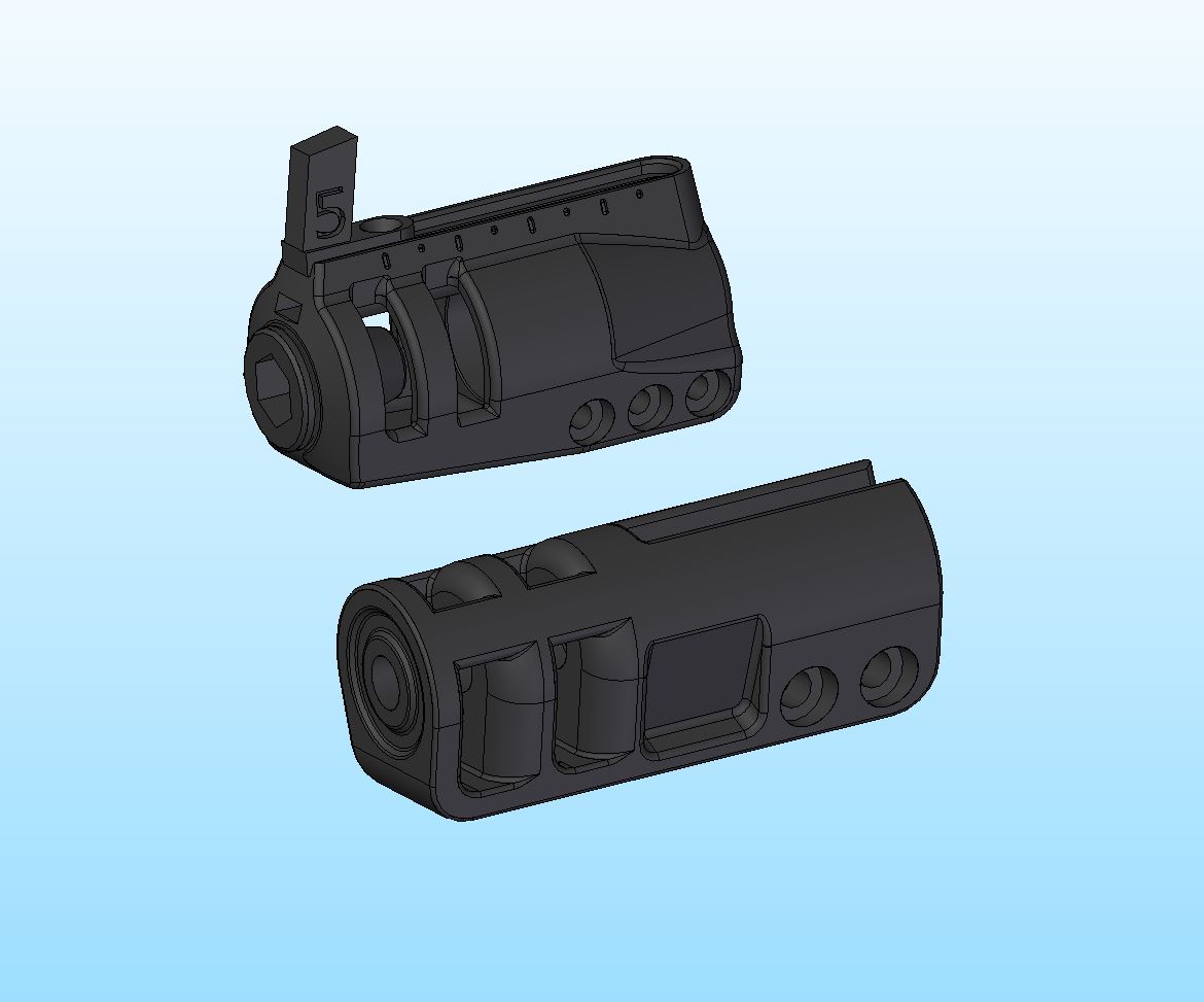

I have done both Toz versions. I don't have the pictures right now, but I'll add the drawings.
For the Morini, I also made two additional versions: one a little longer and one much longer.
The first one above is the original Morini front sight holder, the second is the one I normally use, the other two are special requests.
I also made one for the Hammerli 150.
The one for the Morini uses the original sights, while the ones for the Toz and the Hammerli need a special sight, which I always print in the same material.
Since it is matte black, it works well.
As you can see, once I got the hang of designing them, I had a lot of fun.

Nice designs!

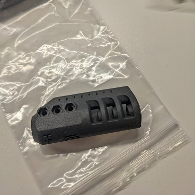

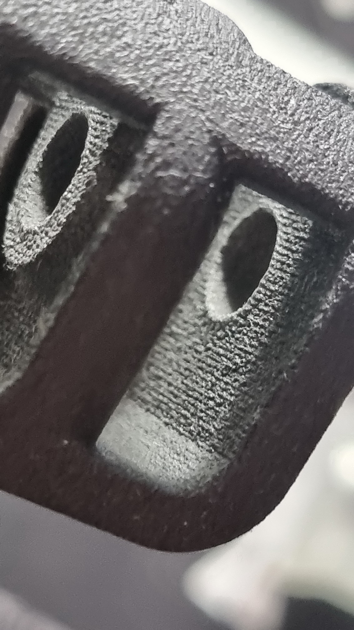

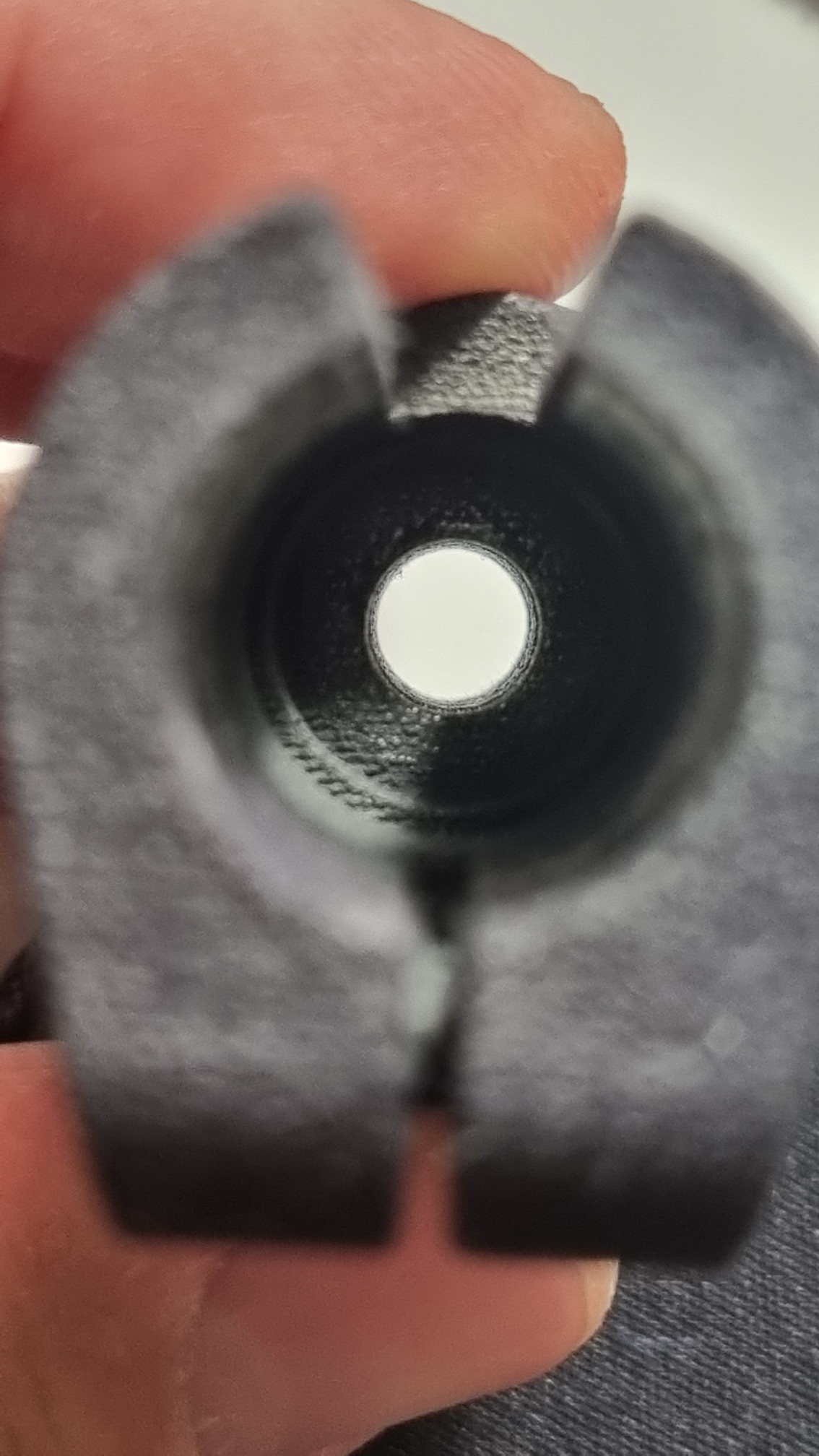

How well does the compensator section hold up to firing? My Morini arrived with the compensator forward. It got coated internally with lead & powder fouling fairly quickly, and was a pain to clean. I gave up & moved it back so the that front of the compensator was flush with the end of the barrel. I don't mind the weight/balance with the compensator moved back, and I never found the lack of "compensation" to be noticeable.
The aluminum factory version didn't care about the burst of hot flame from muzzle blast, but I'm surprised the nylon doesn't eventually get toasted. If I were to get one, I think I'd like to get a spare for the day the first one gets too singed.

Re: Morini free pistol compensator
Post by LukeP »
I can only speak from the experience of the last two years: the Morini compensator, which I have always used, shows no signs of 'wear' in the part hit by the gas jet. In fact, it seems quite easy to clean with a toothbrush, you remove most of the residue and only the surface remains dirty, but I think it's an initial effect that doesn't change. On paper, the material is durable and does not suffer from the immediate heat of firing. Next week I'll go to the range and take some photos of the uncleaned compensator from earlier in the year to get an idea of the type of deposit that forms and after how many shots.
As for the aluminium one, I don't know about the material or the shape, but you're not the only one who's found it difficult to clean.
On the Toz compensator, I tried a conical nozzle at the front that could be unscrewed for cleaning or replacement. One shooter in particular had asked me for it. I have not yet found the need for this on the Morini, but never say never.

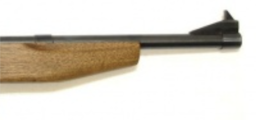

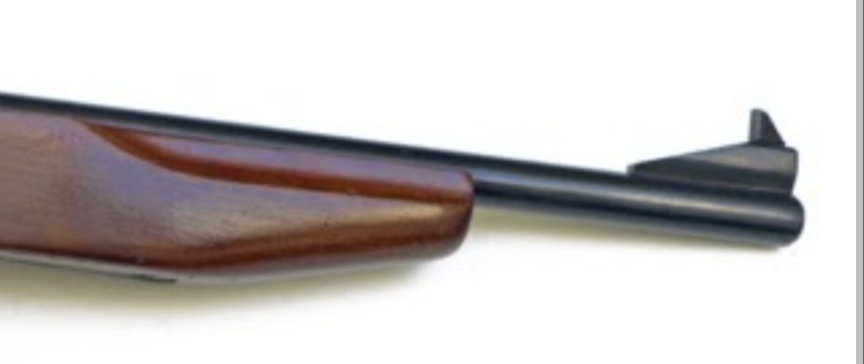

My TOZ 35M has the front sight that has a replaceable blade but the base is pretty much permanently mounted on the barrel. Does that make sense?

In my limited experience:
This version has a kind of round strap that comes off.
This one has everything welded to the barrel.
Posts: 452
i saw your post on egun, selling the morini compensator
i would like the TOZ-35 one - old version with the front sight welded to the barrel. (TOZ-35M is the new version with the removable front sight)

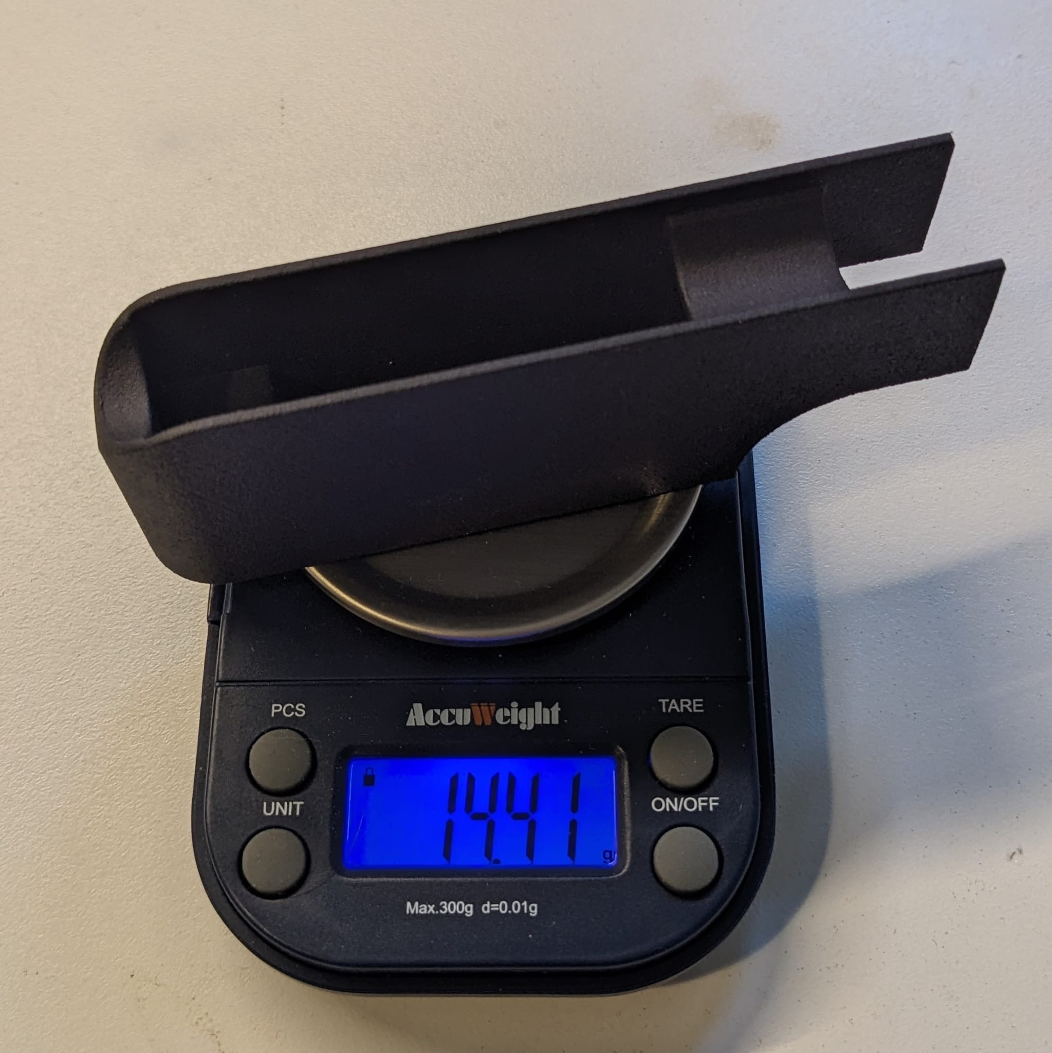

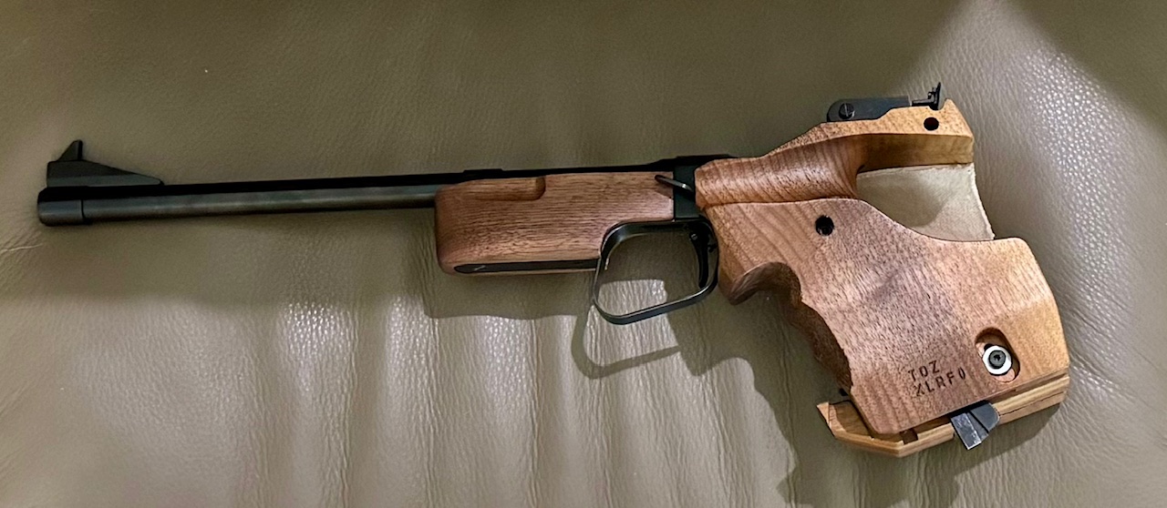

A super lightweight minimalist TOZ fore end that would just keep the delicate parts covered up might be a good seller too.
DLB
LukeP
Posts: 295
Location: Italy
Post by LukeP »
Not much left to lighten up 😅

The TOZ fore hand in the photo is the first prototype, I still have to adjust a few things...
All the compensators, on the other hand, I already have them cyclically available.

You have me beat by about 10 grams or so!

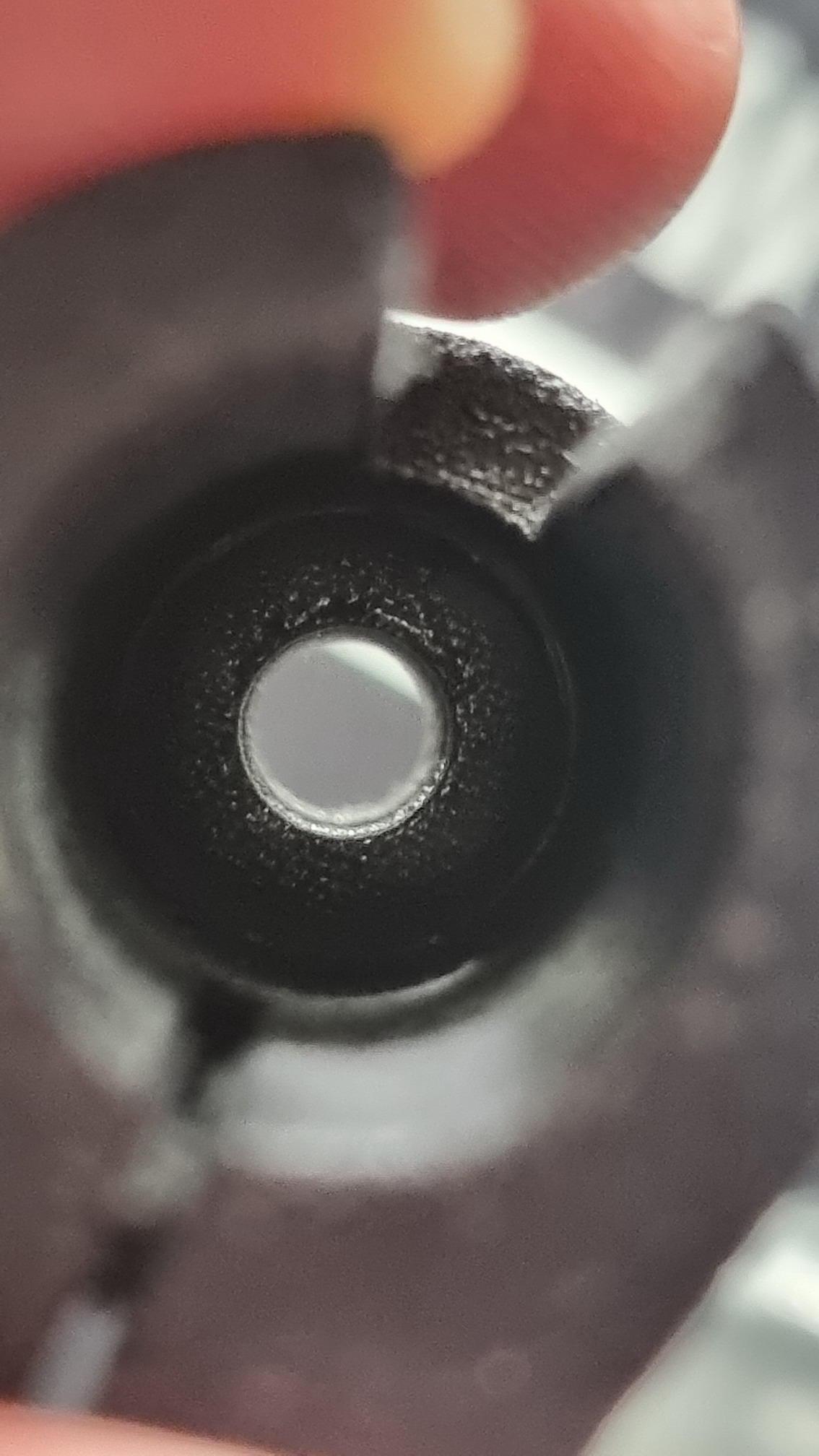

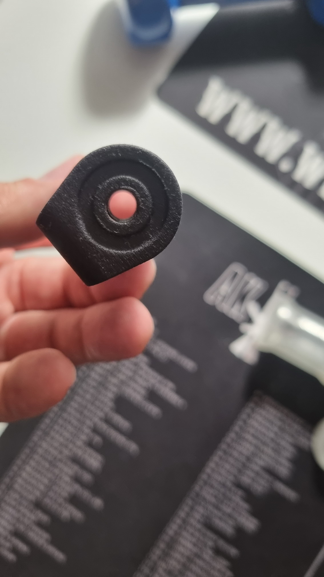

got the compensator for the TOZ-35 and tested it today. the guns jumps less and you can feel that the muzzle is heavier
the first shots were reeeally high. more that a target high. but after ~15 shots, they got back down where they used to be.
i had the impression that the front hole got a bit elongated downwards, but after watching the photos i don;t see it anymore :/
the comp and the muzzle got a little smokey after 35 shots, but no deposits.
