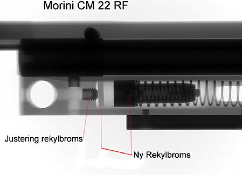

First things first, here is a see through image of how the recoil system is engineered:

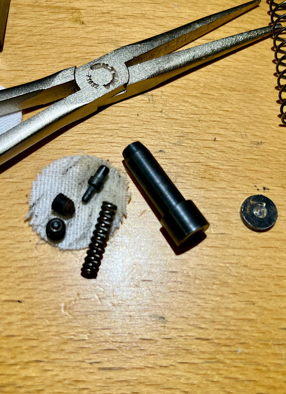

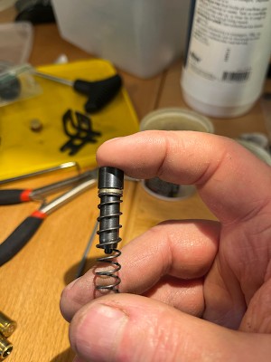

The big spring is the regular recoil spring, look closely and you will notice a smaller spring inside the guide rod that supports a pin that catches the slide in the rear most position of the stroke dampening the blowback.
I havent found any information about the pre load of this spring, nor do I own a spring weight gauge, but taking it apart I found it to be adjustable.
I guess the pre load is set at factory never meant to be adjusted, I just counted the turns and gave it a tad more pre load for good measure. As one do.

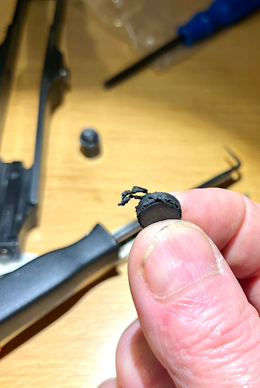

The guide rod (containing the pin/ spring assembly) is resting on a rubber stop to further dampen the blowback as the slide bottoms out while cycling.
This rubber stop was… almost not any more.
I do like to invent stuff as you soon will come to understand, but I also know my limits.

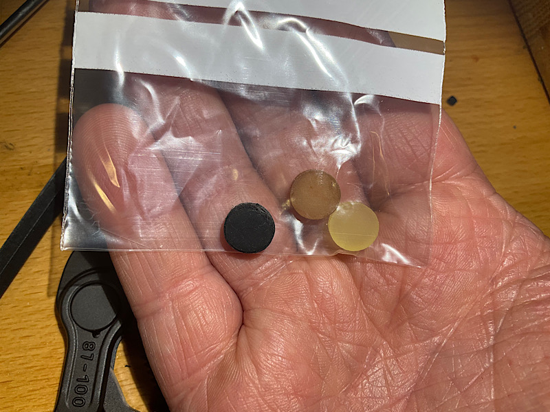

I sent a mail to Ronny as Interprodukter and got a reply not five minutes later simply asking if my adress still was the same. On a sunday night..!
Two days later I recieved this, for free. Amazing service!
I cleared out the rubber goo from the recoil assembly seat and put the new rubber stop in place.
Looking at the top picture you will see the adjustment screw to set the pre load for the recoil spring as well as the stroke length for the slide.
I gave this screw a good four turns (six turns is max before it unseats itself forward) and found that the slide now was real hard to lock back as I had moved the guide rod/buffer assembly far enough forward so that I now had to compress the buffer pin spring when locking back the slide.

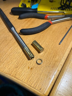

I wanted to move the slide stop back aboud two mm but keep the pre load of the recoil spring, so I had to get creative.
I backed off the recoil spring assembly set screw all the way and made shims to adjust the recoil buffer until the slide locked back just as it hit the buffer pin.
Now all I had to do was to find a way to pre load the recoil spring the same amount as I moved the buffer assembly back.

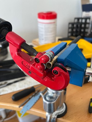

I wanted to use brass and found that a 32WC case had pretty much the perfect dimentions.
Drilled out the bottom to 7mm using the bung hole as guide then cut off the rim with a pipe cutter

As the washer was almost done all I had to do was fine tune the fit with a needle file et vȯila:
Now I had a full stroke for the slide while maintaing the pre load for the recoil spring.
With this washer I have about one mm before the recoil spring is fully compressed as the buffer pin bottoms out in the guide rod assembly, almost ideal.
