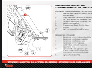

My Pardini K12 is shooting slow. Using a chronograph (Garmin) it is shooting around 108mps or 350fps with H&N final match and slower with RWS R10. Other quality air pistols using the same chronograph during the same testing session are shooting around 158mps or 490fps.
Observation: The screw MP is fully screwed into the frame. When it is loosened the velocity decreases to 80mps or 260 fps.

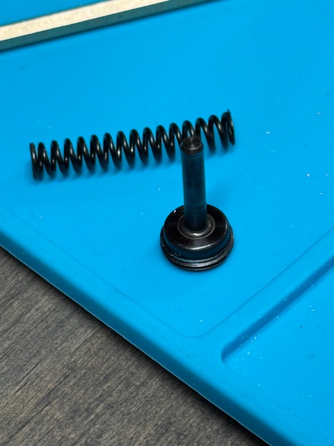

While it is hard to diagnose a problem sight unseen, I’m wondering if anyone has had a similar issue. The firing pin spring is intact, but slightly curved. Not sure if a new spring or stronger spring would make a difference.

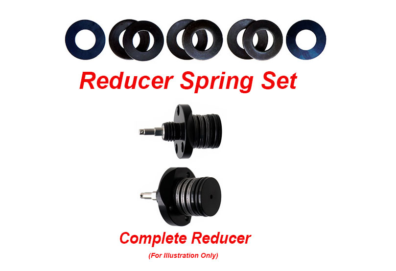

The Pardini K12 pressure regulator uses a spring pile of 6 Belleville Spring Washer's back to back.
The easy way is to replace the pressure regulator, the hard way is to find the replacement
Belleville Spring Washer's of the right size.

Belleville washers typically can't flex far enough to lose compression. I've rebuilt a bunch of Benelli Kite regulators, and I re-used the Belleville springs. The velocity generally comes up pretty close to where it's supposed to be.
I've rebuilt over 20 Hammerli AP40 regulators, and reused the coil springs. All they needed to get pretty close to the nominal velocity was replacement of the piston seal. I think what happens is the seals wear (or in many cases, start to disintegrate), which reduces the friction. That makes it easier for the piston to move, which results in the regulator valve closing at a lower pressure than desired.

Brian don't start pulling it all to bits and worrying - do the simple tings first - change the spring as all springs will slowly take set over time especially if left cocked in the case for long periods. When you have put in the new spring monitor the speed for a while. My Spring lived good and strong for over 10 years of constant use but suddenly died, as you know simple job to deal with.

I replaced the firing pin spring with a generic coil spring nearly identical in size to the factory spring that my local gunsmith had on hand. Not it shoots consistently 480fps. I also inspected the o-rings and they are all present and appear to be in good shape.
