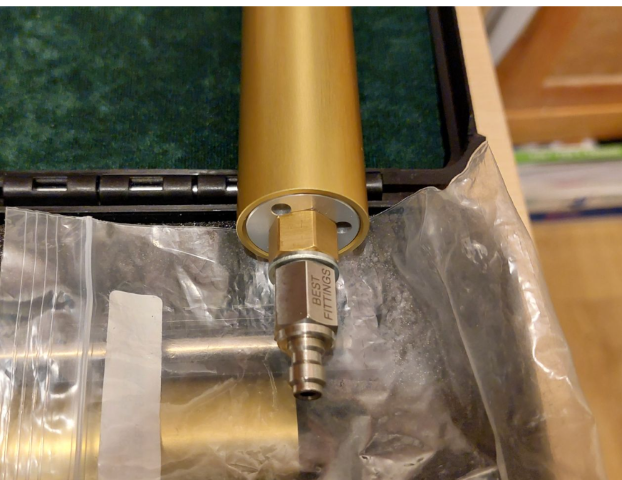

Does anyone have/use one of the Best Fittings Steyr LP fill adapters? The description states that they are now “drilled through “ to allow for conventional bleeding of the charging system without the need to partly unscrew the reservoir whilst still under pressure.
https://www.bestfittings.co.uk/shop/fil ... l-adaptor/
I always get a little nervous while doing this, seems like a better idea.

Yes. We use the BEST fittings adapters for both Steyr and Walther air guns. They work fine.
This is the Steyr adapter that allows you to unscrew with cylinder without pressure on the threads-

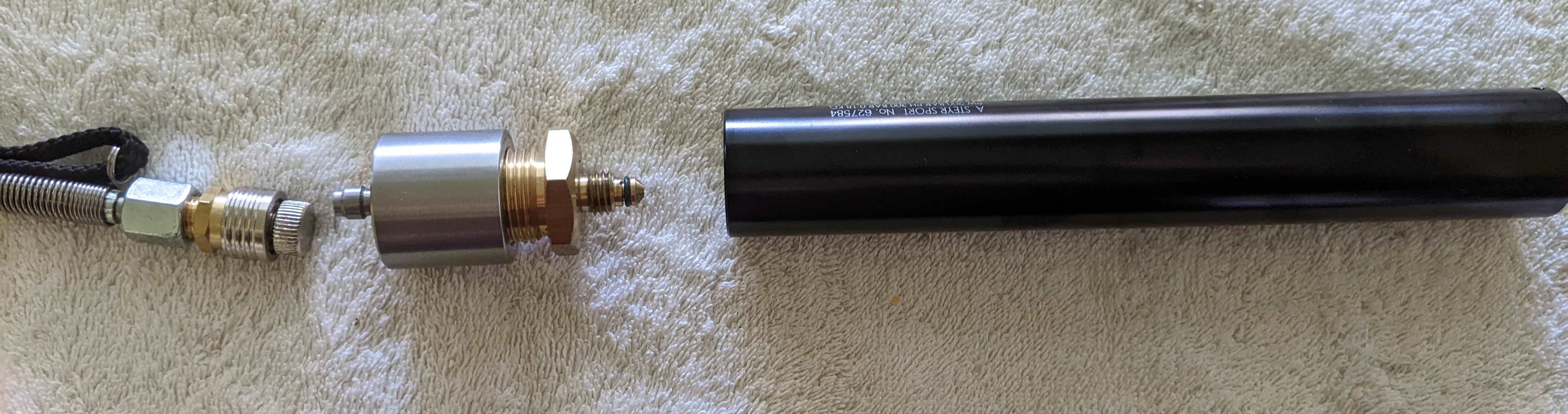

Just to be clear, you can bleed the line pressure first and then unscrew the cylinder under no pressure?
Is your setup similar to mine? I have the Steyr supplied fill probe.

The cylinder unscrews, unpressurized, due to the design of the adapter. Less loss of air.
In re setup...No, we also use a pressure release valve in-line.

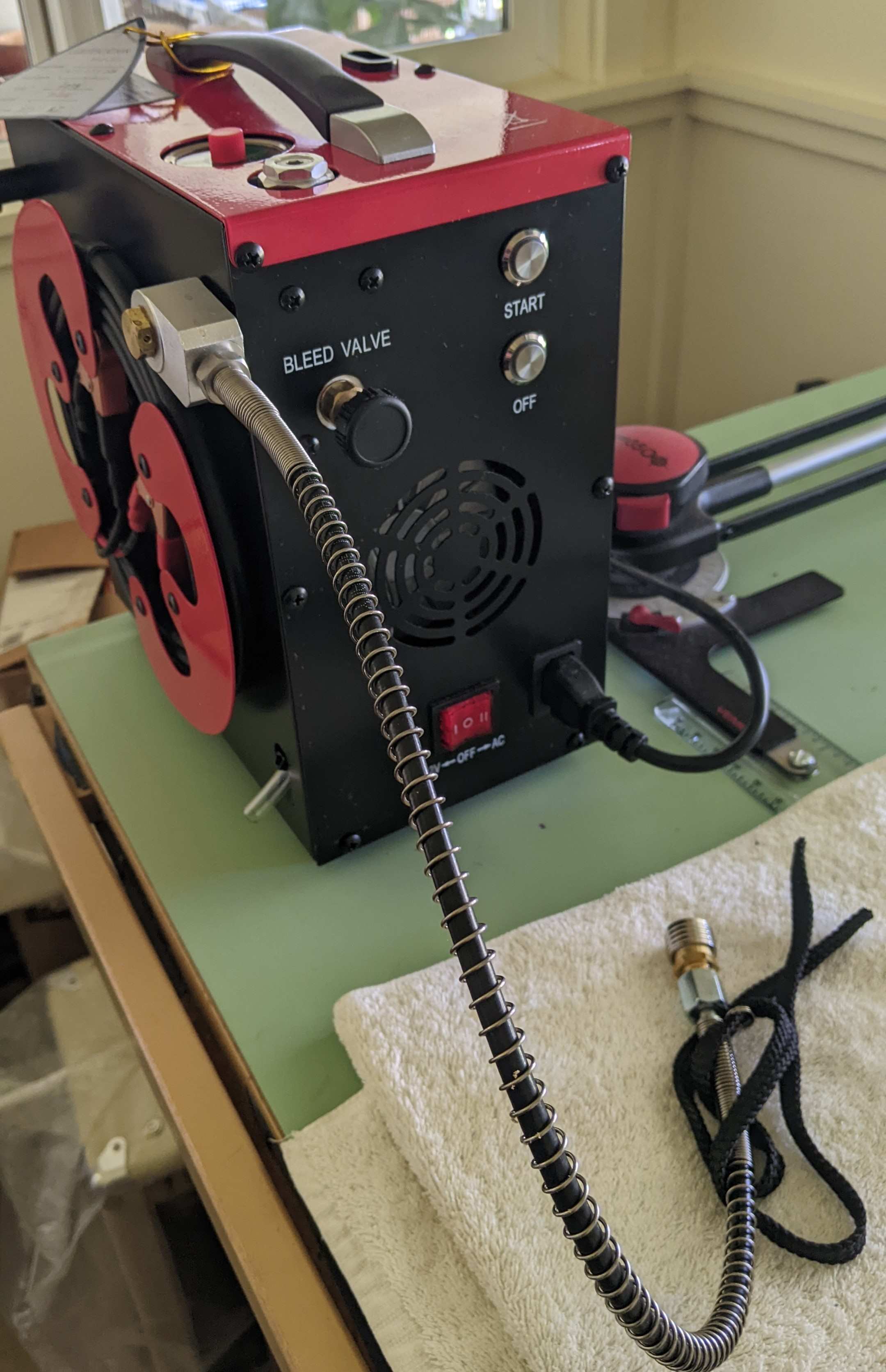

Not everyone fills from a bottle or tank. I use one of the cheap Chinese compressors straight to the air cylinder. No trip to the dive shop!

If you can bleed the hose of that compressor there's no reason why you shouldn't use one of the BF adaptors with a foster connection, like so:

I got this cheap compressor but unfortunately it's DOA.. won't start compressing at all and I am considering hacking it..
Gwelo wrote: Mon Jan 20, 2025 6:14 pm Not everyone fills from a bottle or tank. I use one of the cheap Chinese compressors straight to the air cylinder. No trip to the dive shop!
