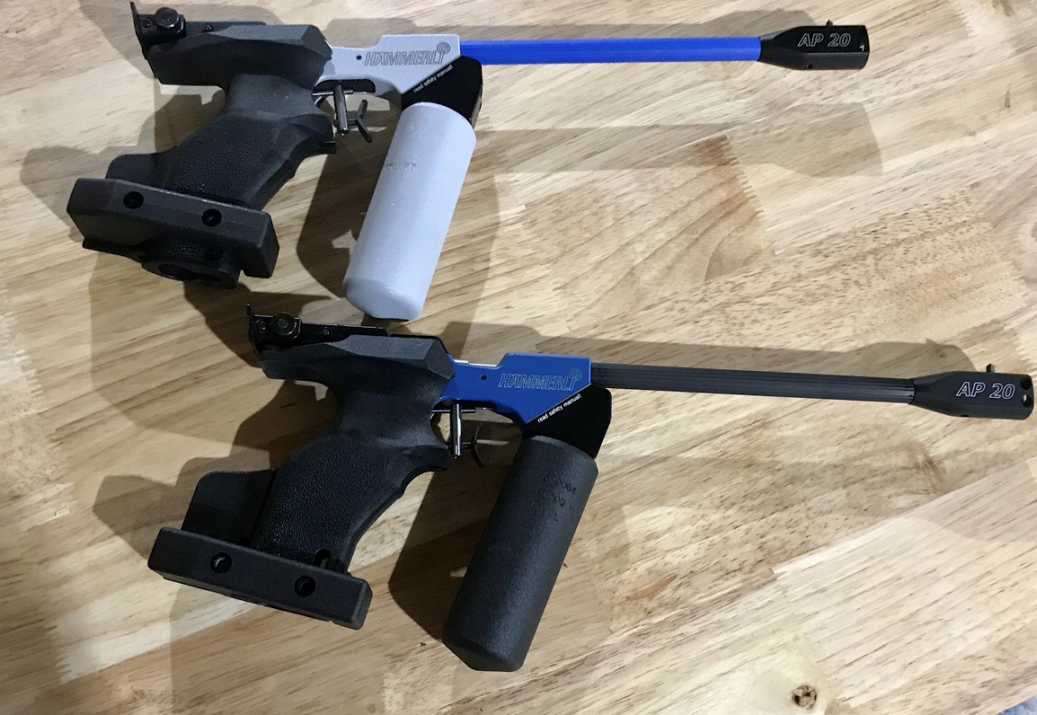

Hi all -
First time poster here, thanks for being such an incredible reference for a new shooter!
I purchased a Hammerli AP20 Pro, and unlike almost every picture I have seen online, it arrived with a blue body, and a black air cylendar. Does anyone know if this is a new colorway, or a different model of the AP20 pro? The only blue versions I have seen has been on a European vendor sight and on carl-walther.com itself. Essentially, I just want to be sure there were no recent updates and that I'm not holding an older version of this pistol.
Also, unrelated, is it safe/possible to fill the cylendar directly with my GX CS3-I pump? Or am I supposed to go to a tank between the two? The manual doesn’t seem to say anything about this.
Thanks for any help you can offer

We have both in our group (standard AP-20's). From what I can tell there is no difference, other than color. The blue version with the black cylinders is the newer version. I would not worry, with either version. They are quite reliable air pistols.

Thanks for the picture. I have the pro model, but I’m quite sure the mechanics are the exact same outside of the tank justification and grip.
