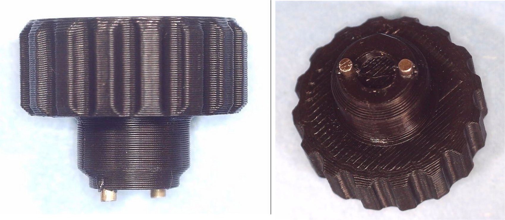

It's taken 6 years of research since he died, but I now have the parts, tools and expertise to fix the 12 dead pistols we have now. One issue is that you need a special small pin spanner to take the regulators apart. I spent considerable time machining a fancy one out of steel, only to discover that the force required to unscrew the adjustment bushing is pretty low. I designed a 3D printed tool with a U-pin of spring steel, and made up a batch:

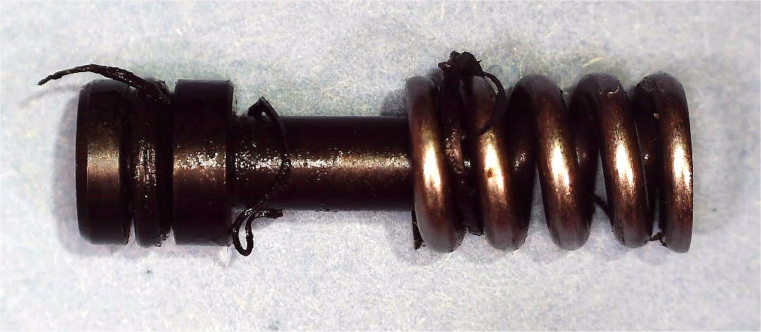

The problem is a special piston seal they use in the regulator. Instead of an O-ring, they use a "X-Ring", sometimes known as a Quad-Ring. These tend to shred:
Many of the repair parts for the pistol are used in other Hammerli/Walther air guns, and are still available, but not the piston seals. I suspect they ran out of spares a while go due to the high failure rate. I managed to buy a couple complete AP40 regulators, which included the required seals. I measured them, assuming they were going to be some exotic metric X-ring. I discovered they are bog standard "-007" sized ASTM/SAE X-Rings, available from McMaster Carr at $11.21/100.

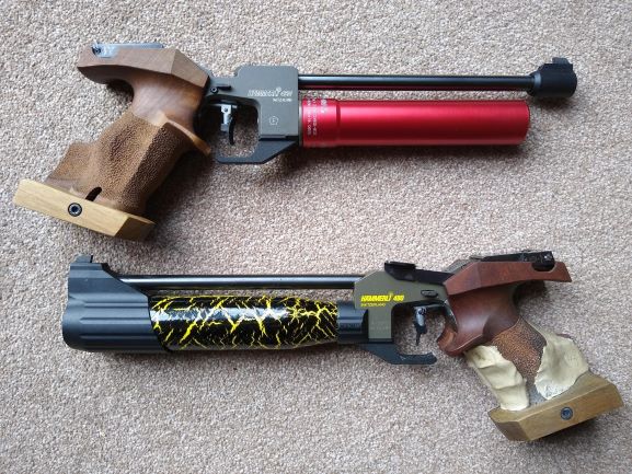

Are there any options available for replacement cylinders to suit the 480K2 ?
Re: Anyone Need Repair Info on Hammerli AP40 or Converted 480K Air Pistols?
Not that I'm aware of. As far as I know, the K2 used the same regulator design as the original 480's. They tended to fail, and there are no parts available. I think the conversion to AP40 cylinders would work on those as well, but those parts are also no longer available. I may have a lead on finding one or two, but they require fitting to each pistol.
