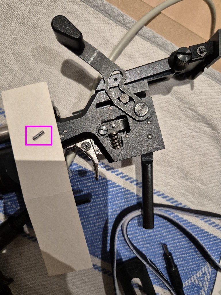

My daughter's LP2 just malfunctioned during a dry firing session. The loading lever is no longer cocking the striker. The loading lever is still properly attached to the gun and is moving normally. It just appears to have no contact with the striker.
A metal pin came loose from somewhere. Diameter 2.00mm (0.079") and length 7.90mm (0.311"). Certainly that's at least a part of the problem, but I can't figure out where it belongs.

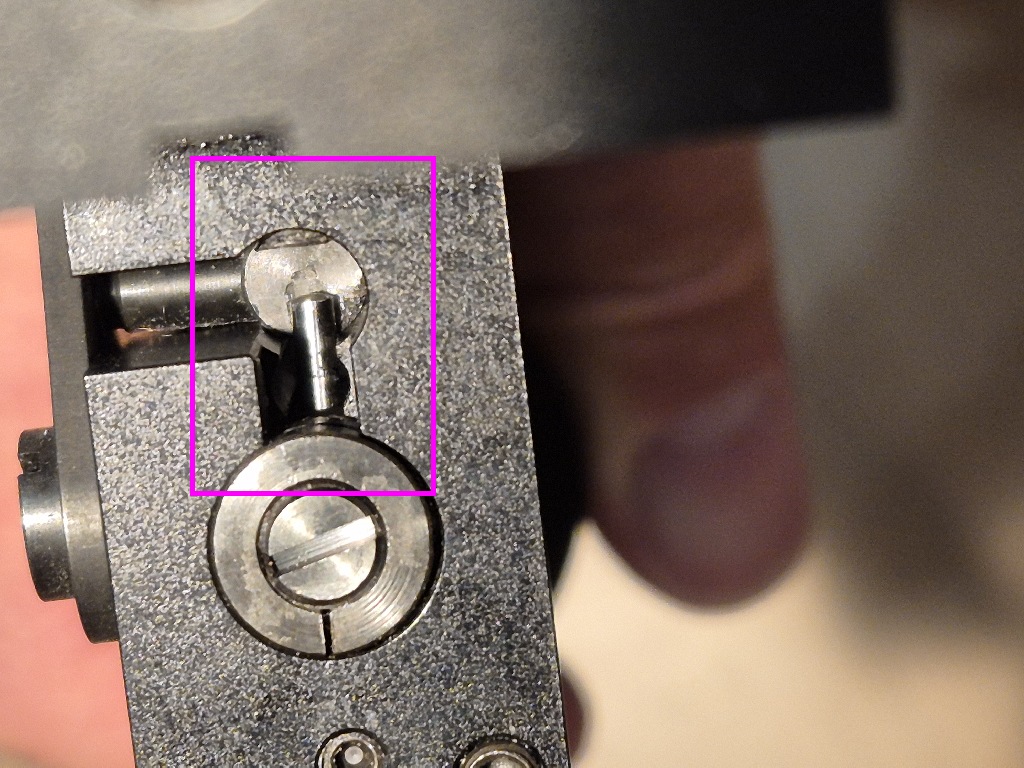

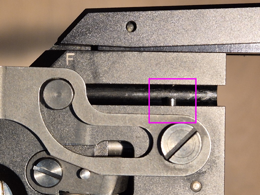

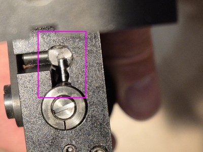

I'm guessing the problem is not related to the trigger. Maybe this is where that pin used to sit?
Maybe that used to be a separate pin sitting in a hole on the striker? My daughter's gun is an LP2 with serial 9001xx. Don't know if that's an older model.

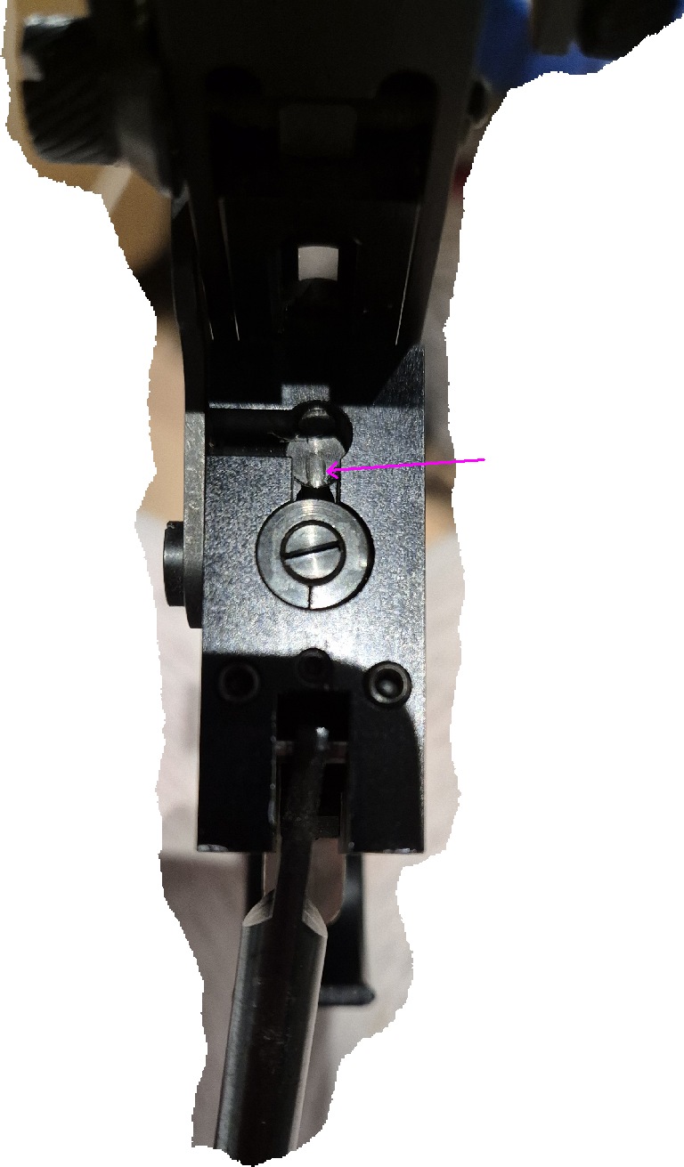

I've now tried to reinstall the pin by blindly fumbling around, i.e. no disassembly was done. The mechanism is working normally, FOR NOW . . .

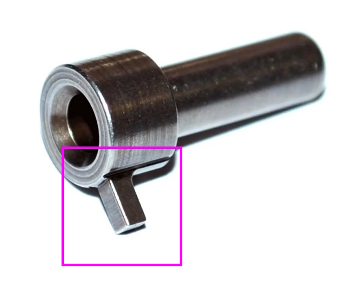

It looks like they changed the design from having an integral pin to using a separate pin (or vice versa, depending on the serial numbers). If the round pin is loose enough to fall out again, you can try using a tiny amount of "retaining compound", which is basically a glue made by the LocTite folks.
https://www.mcmaster.com/91458A230/
If the integral pin is the newer version (which I suspect it is), you could try contacting Steyr or Pilkguns to see if your pistol can be retrofitted with one. Neal Stepp may also have the part you need.
