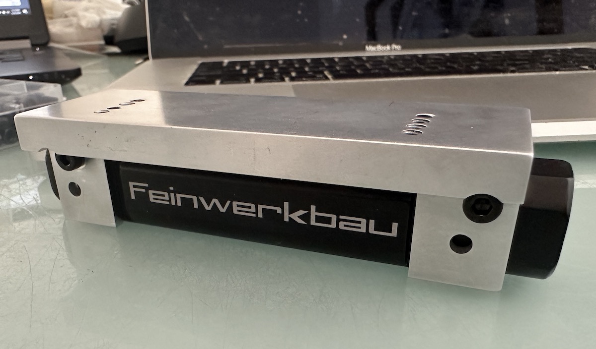

I had a shooter who's gun went into full gymnastic mode on the storage rack, and bent the bridge up.
My first choice to get them back into service was to just drill and tap the extension for a Tec-HRO top rail, in a dovetail format that matched their SB rifle (Anschutz in this case) for commonality. I didn't see any real physical issues with doing this (I was planning on using 4-5 screws), but the shooter wanted something more along the lines of the factory setup.
We ended up going with this heavy duty version of the bridge, with just a few holes that matched her usual height adjustment (why remove metal if you don't have to). This ended up being heavy duty enough to be used in hand to hand combat if needed, and added a few grams to the front, that they wanted.
In the end though, we could have saved a bunch of R&D and machining time, by just attaching a dovetail... so I would seriously consider doing that for the front.
