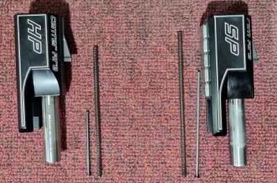

Hi, I have the Pardini HP, and it has been set up as 22 since I bought it.
I cannot for the life of me remember where the parts are for it, other than the 32 barrel.
My question is. When I change from 22 to 32 and vice versa, can I use the same guide rod and guide rod spring for either 22/32?
Or are these unique to the barrel?
Thanks in advance

Yes, they are the same.

Ramon OP wrote: Tue Jul 16, 2024 5:33 am Yes, they are the same.
Thanks for that. What confused me is the different part number here on SP (716) and HP (816):
https://www.pardiniguns.com/store/image ... iagram.php

Not sure,
I check with the conversion here in France, .22 spring lenth is 130mm rod is 95 mm
.32 Spring 116 mm rod 56 mm ???

Post by fc60 »
Greetings,
The recoil springs are different.
The 32 spring has larger diameter wire and is shorter than the 22 spring.

Pardini over stresses their springs. They will shorten by quite a few mm just from use. The only accurate way to compare them is to count the number of turns, and accurately measure the wire size. A caliper isn't really good enough for that. You need to use a micrometer, and support the inside with a snug fitting drill shank. Measure the drill diameter, and then the OD of the spring on the drill. Take the difference & divide by two to get the wire diameter.

The sizes (lenghts) i wrote comes on brand new springs for both.

Jeff-France wrote: Wed Jul 17, 2024 11:10 am Hi,
Awesome, thanks. That makes sense because I did find the shorter guide rod. So that must be for the 32.

Let me be more precise: I've been told by an armurer that they were the same. Maybe they are interchangeable ?

i got a Pardini SP with the HP conversion kit
the springs and the guide rods are definitely not the same. the HP spring is much stronger
