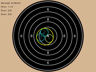

A calibration routine is performed when commencing firing - this can be based on the average of a number of shots taken for dry-firing practice, or it can be manually adjusted to match where the shots land in live-firing.
Once calibration is complete the program enters training mode. The shooter's movement is scaled up to represent where shots would land at the 'real' distance, and scores awarded based on this.

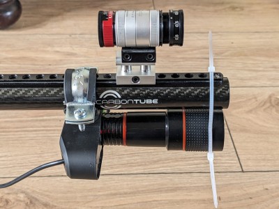

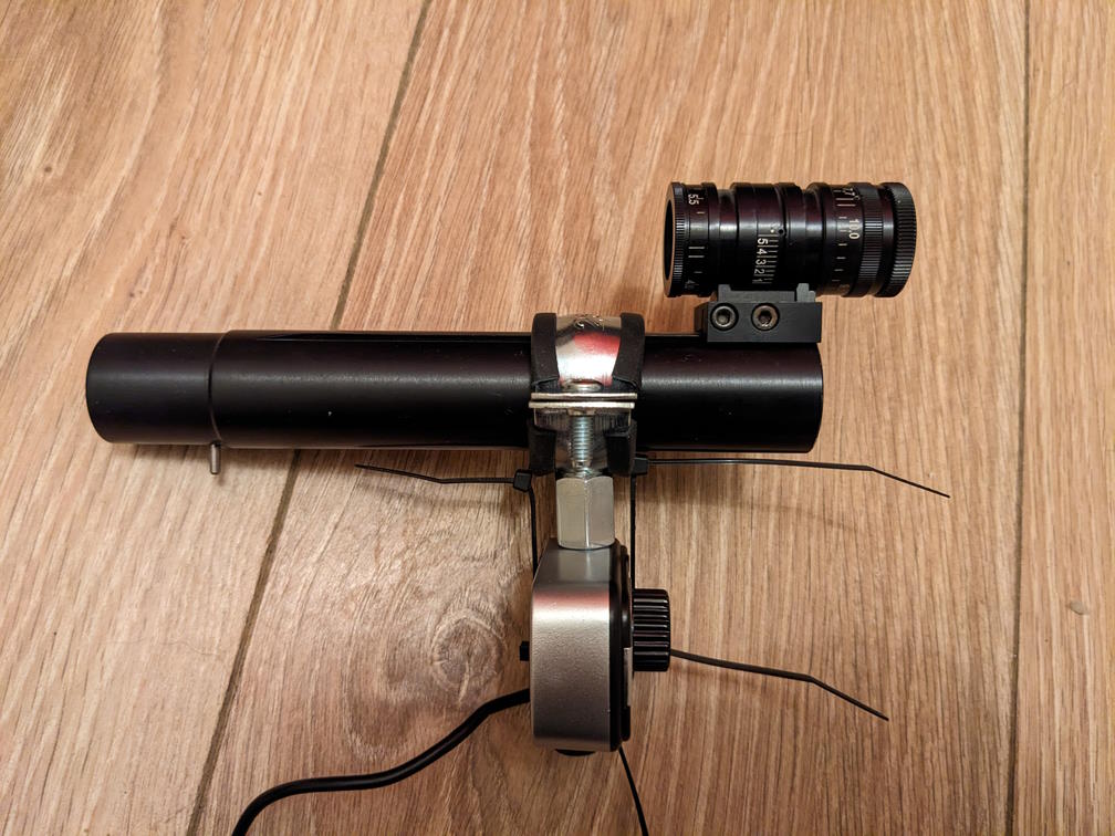

I've got this more-or-less working. I bodged a smartphone telephoto lens to the webcam to 'see' the IR LED better and reduce its field of vision (picture attached).
It needs securing better as it tends to move around a bit, but that's a job for another day.

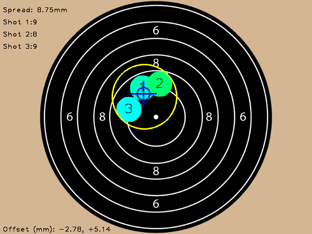

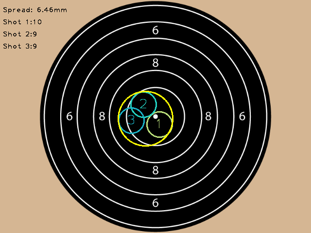

Also attached is the composite output from that session:

Added an average-shot-location indicator, along with a windage/elevation offset output thingy.
