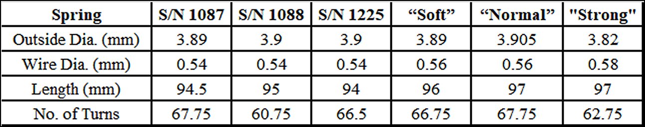

Here's a table of the MG2 springs I've encountered:
I ordered (in theory) a set of all three possible strengths to experiment with. If you look closely, the "Soft" and "Normal" springs I received are basically identical... Based on the wire diameter, it looks like all three of the pistols came with "Soft" springs and they sent me two sets of "Normal" springs.
If you can tell the factory what the measurements are of the springs you have, they should be able to tell you what strength they are. If you are experiencing doubling, you want springs that are softer. If they don't have multiple spring strengths, or you already have the softest ones, you could buy a pair of the same strength and cut turns off to weaken them. If you are getting doubling with only 1 round in 10, it shouldn't take too much trimming to fix it. You may want to keep two sets of springs handy to deal with whatever ammo you can get at a given time.

Gwhite wrote: Mon Jun 10, 2024 12:55 pm If you want to try different recoil springs (and they are available), it helps if you can figure out what you've got. You need the length (which is easy), the outside diameter (easy), the number of turns and the wire diameter. The number of turns can be a little tricky. I made up a template to make it easier to count accurately (attached). It's designed for Benelli MP90/95 springs and MG2 springs, so I don't know how well it will work for the MG4, but it may help.
Recoil Spring Gauge.pdf
Measuring the wire diameter is also tricky, because a very small change in the wire diameter has a big effect on the strength. A simple caliper isn't really accurate enough to provide the required precision. The best way to do it is to use a micrometer. Find a drill bit whose shank is a snug fit inside the spring, and then use the micrometer to measure the diameter of the drill bit and then the outside diameter of the spring with the drill inside. The wire diameter is half the difference between those two measurements.

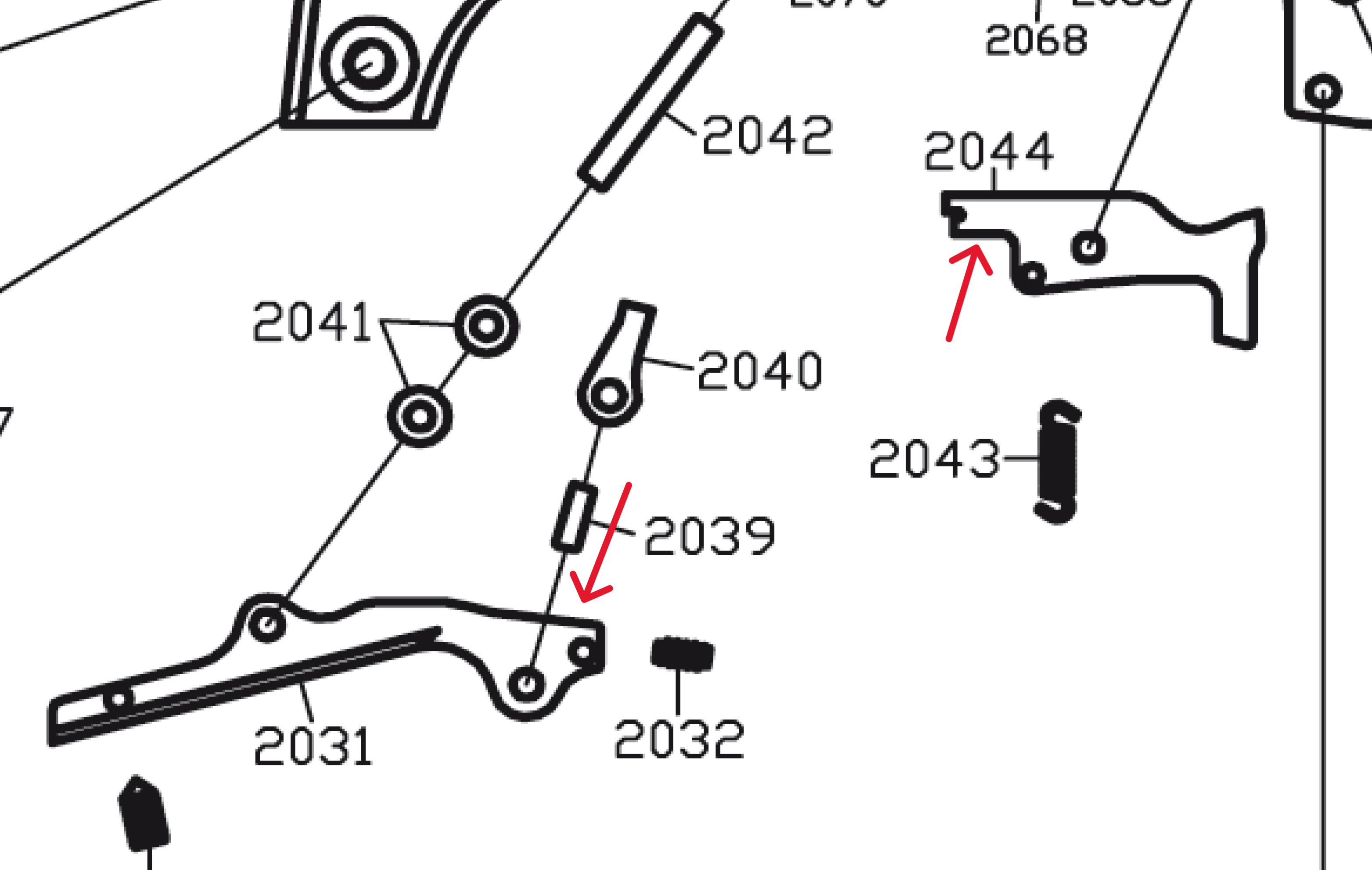

We recently came across a new MG4 ACP with double fire issue. The ammo we used was custom loaded. Jon did a thorough adjustment on all the trigger setting screws. The pistol still fired two shots consecutively sometimes.
After Jon took a careful look inside the pistol frame, he saw the front bottom side of the release lever (pn 2044) was touching the upper rear end of trigger holder or trigger bar (pn 2031, portagrilletto) when the trigger was pulled all the way to the back. Please see the attached drawing cropped from the user manual.
Jon used a Dremel grinder to remove a small amount metal from the front bottom surface of the release lever. The upper arrow in the attached drawing points to this surface. This solved the double fire issue.
Good luck in fixing the double fire issue.
