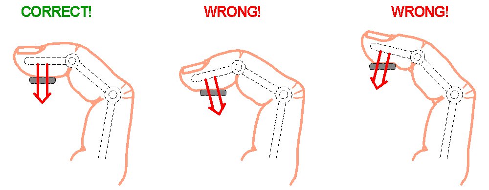

Step 2: Make sure you are placing your finger on the trigger correctly. For precision shooting, you want to locate the "pad" near the tip of your finger on the trigger. This is the most sensitive part of your finger.
Step 3: There is a "proper" trigger location, but it's not as critical as some people make it out to be. The finger joints all pivot, so pulling straight back is tricky. The goal is to have the trigger face located so that the force from your finger is in line with the barrel at the point where the pistol fires. That will minimize any disturbance to the sight alignment. Assuming you are right handed, if the trigger is too far forward, you will tend to push the pistol to the left. If the trigger is too far back, you will tend to pull the pistol to the right.
Trigger Location.jpg (52.22 KiB) Viewed 4777 times
Don't get too cranked up about making it exact. Plus or minus a millimeter doesn't make a big difference.

As usual, GWhite has the best answer. I have actually seen some good results with the second joint on the trigger, but it can't be said ideal.

It´s interesting how wide the trigger blade is shown.
Posts: 3566
Re: How far back should the trigger be
Trigger width tends to vary quite a bit from manufacturer to manufacturer. The standard Steyr air pistol trigger is actually a bit wider than the pictures show, but Morini triggers are a bit more narrow and rounded on the front. I've lost a lot of the sensitivity in my finger tip over the years, and now shoot with a trigger with fairly aggressive "tread":

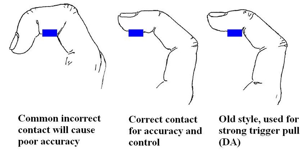

Gwhite wrote: Sun Jun 02, 2024 8:59 am trigger-contact.jpg
The centre diagram (centre finger pad) is better for precision shooting, Free/Air and Sport.
The right hand diagram ( trigger into joint) is better for heavier trigger/recoil type shooting.
Ideally suited for double action revolvers.
The one thing missing is that this is the trigger position at "Trigger Point" (break point) not initial
trigger contact point.
Movement of trigger position forward or back as little as 1-2mm can make a big difference and
will move the impact group on a target. The best position can be found by range testing.

This is exactly what I noticed: the position at the 'wall' should be as shown. Moving my Steyr trigger forward 1 mm recently for me seems to have improved the feel and - to some extent - scores.
