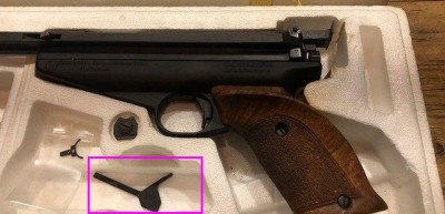

I just purchased a really nice FWB 65 and, as usual with many preowned airguns, you get the gun but no none of the tools that were included in the original box. According to the manual, there is a special wrench used to adjust the trigger and trigger weight. So I’m asking the members if anyone knows where I would go to purchase one, or if a member has one for sale. I suppose it could be a simple Allen wrench but I’m not sure how to tell. Thanks in advance. Dave B

The factory manual may be more use. It appears that the “special wrench “ is used to change from 500 gram to 1350 gram trigger range and to add in recoil for center fire training. The regular 500 gram more or less air pistol trigger seems to just be a screwdriver.

To _nc513_ and Dino911. I found one of those in a Canada vendor on eBay and ordered one, but that is a screwdriver tool, not the wrench that, in looking on the gun where it is inserted, I’d bet is a lot like an Allen wrench

You do not need a special wrench to flip the 500 - 1350 g switch back and forth, any max 3 mm diameter metal peg will do. I can operate mine easily with the longer limb of a 2.5 mm hex key.

Thanks again to all who provided info. According to Airgunwerks, the key like tool shown in k38’s picture is the special wrench. I bought one on eBay from a Canadian dealer and it will arrive soon. ojh’s input seals the deal for me because the tool I bought looks too big to fit in the adjusting opening but I have a 2.5mm hex key. As a mechanically challenged shooter I needed confirmation that an Allen key would work. I appreciate all the replies! Dave B

I've got the FWB "special key" shown in _nc513_'s pic and in dino91's ebay link. Its short end fits nicely into the hole of the 65's trigger weight switch. The long end can be used to turn the fine adjustment screw inside the switch. Since a FWB 65 is today as much a collector item as a sports implement, I'd think your money is not wasted since you'll get an original style tool that does what its designed to do back in the day.
