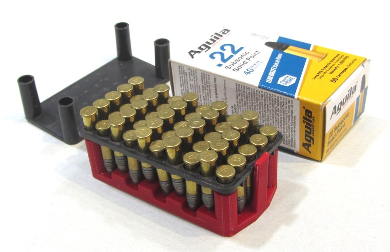

I'm finally getting around to putting some of my shooting related 3D print files on Thingiverse. Most of these were developed for the college team I help coach, but I've also designed some items for my own use.
The first set of designs is for "cartridge lifter" blocks that hold .22 long rifle cartridges in staggered rows of five for easy loading. Here's what the one for Aguila ammo looks like:
I've got designs for Aguila, CCI, RWS/Norma, and SK/Lapua.
Here's the Thingiverse link: https://www.thingiverse.com/thing:6564327
This is the only multi-file posting I've done there. I think it's all set, but please let me know if any of the files are missing or messed up. There is a Zip file that has all the STL files, as well as STEP files if someone wants to edit them.
