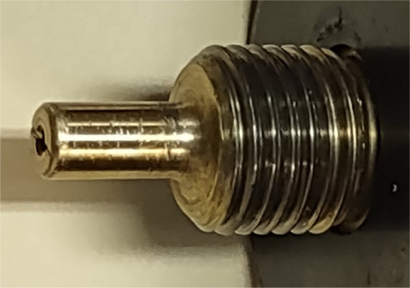

The Morini cylinders do not use an O-ring to seal. It's a "U" seal. On a new cylinder, they should not leak, and if the cylinder doesn't leak when you fill it, the cylinder seal is fine. HOWEVER, they seal against the brass pin the cylinder screws onto. If that is nicked or damaged, the cylinder won't seal.
Benelli Kites use the same system, and are almost interchangeable. Here's what the pin on one pistol looked like after the cylinder was unscrewed, but left loose over the pin in the case:
Cyl Pin Scratches (sm).jpg (51.16 KiB) Viewed 4767 times
The threads on the cylinders are sharp, and anodized (hard). If the cylinder bounces around during transport, they chew up the sealing surface on the brass cylinder mount. This one actually still seals OK, but I have no idea why, given it's condition...

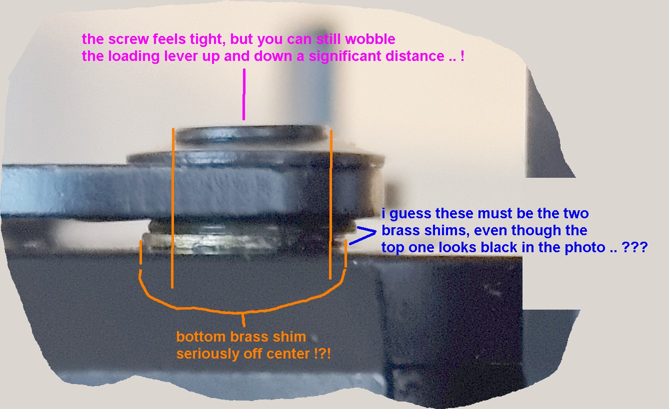

It is certainly a possibility, that when they tightened the screw, the screw started to force the bottom shim down into the threaded hole in the frame. Does this pic give any further clues?
kevinweiho
Posts: 953
Re: Morini CM162EI: Everything's leaking!
Post by kevinweiho »
The screw is misaligned and does not look properly seated, that's the reason it still wobbles. Whoever did this fix is definately not an "airgun smith", but a "franken smith" that doesn't know what he's doing...

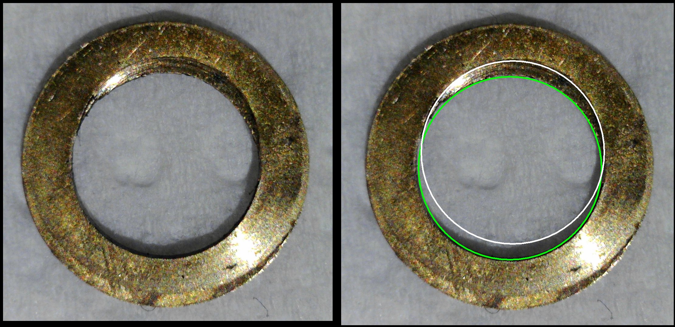

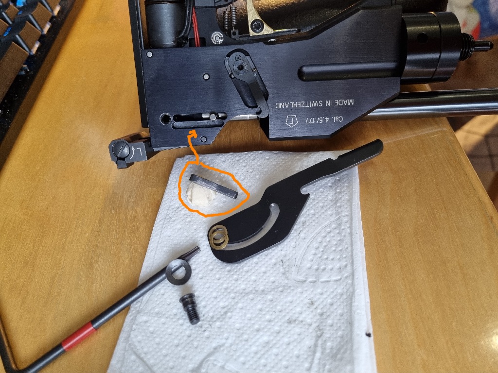

Well, I decided to carefully try opening the loading lever screw. Turns out it was relatively tight, but not at all super tight. It came out all the way smoothly and easily, as I suppose it should.
I believe you were 100% on the right track. It definitely looks like the bottom brass shim got caught under the shoulder of the loading lever screw.

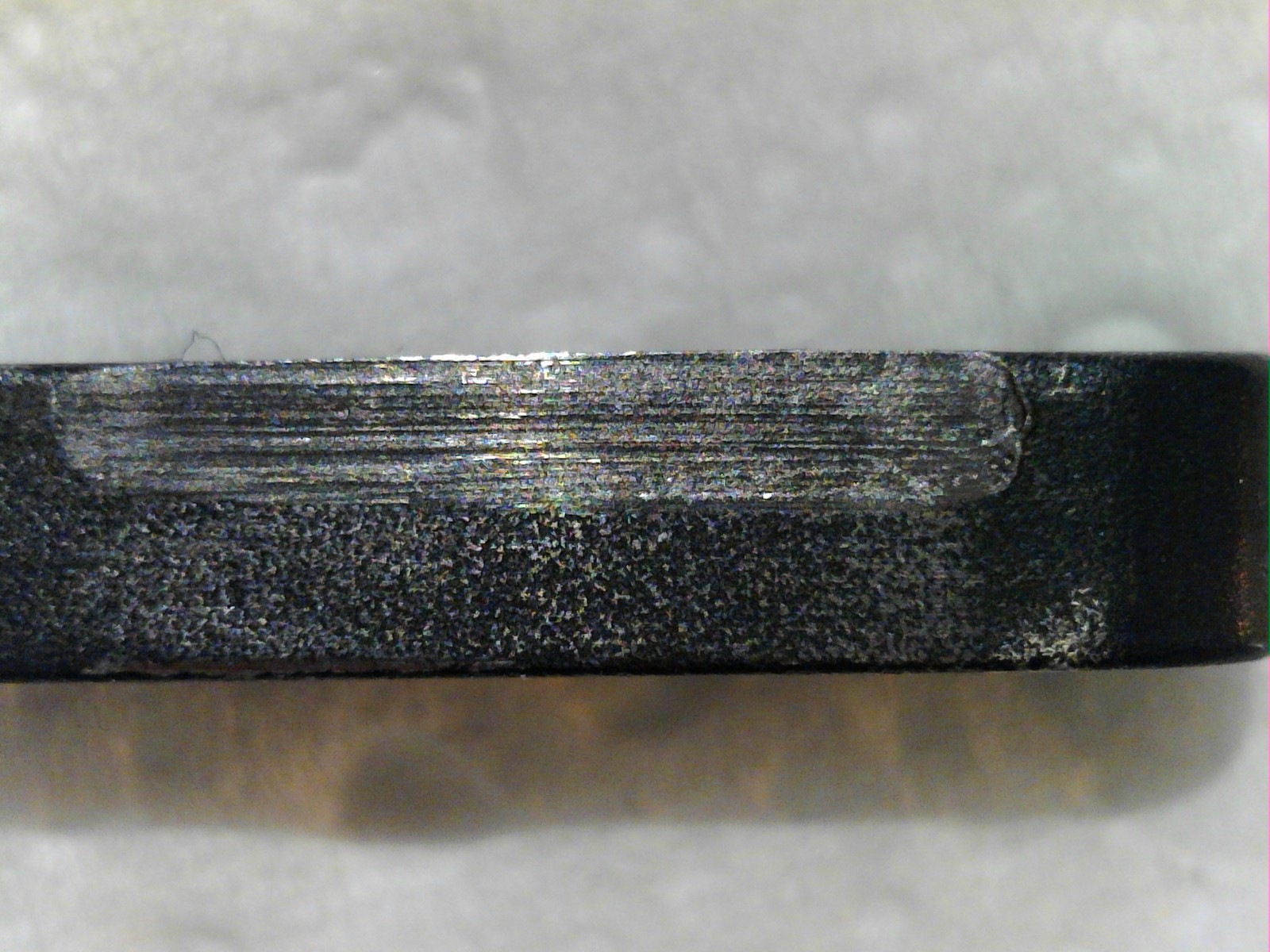

The (removable!) part that the rod #162028 slides against appears to be in quite terrible condition, by the way. The previous tinkerer apparently decided to ignore this.

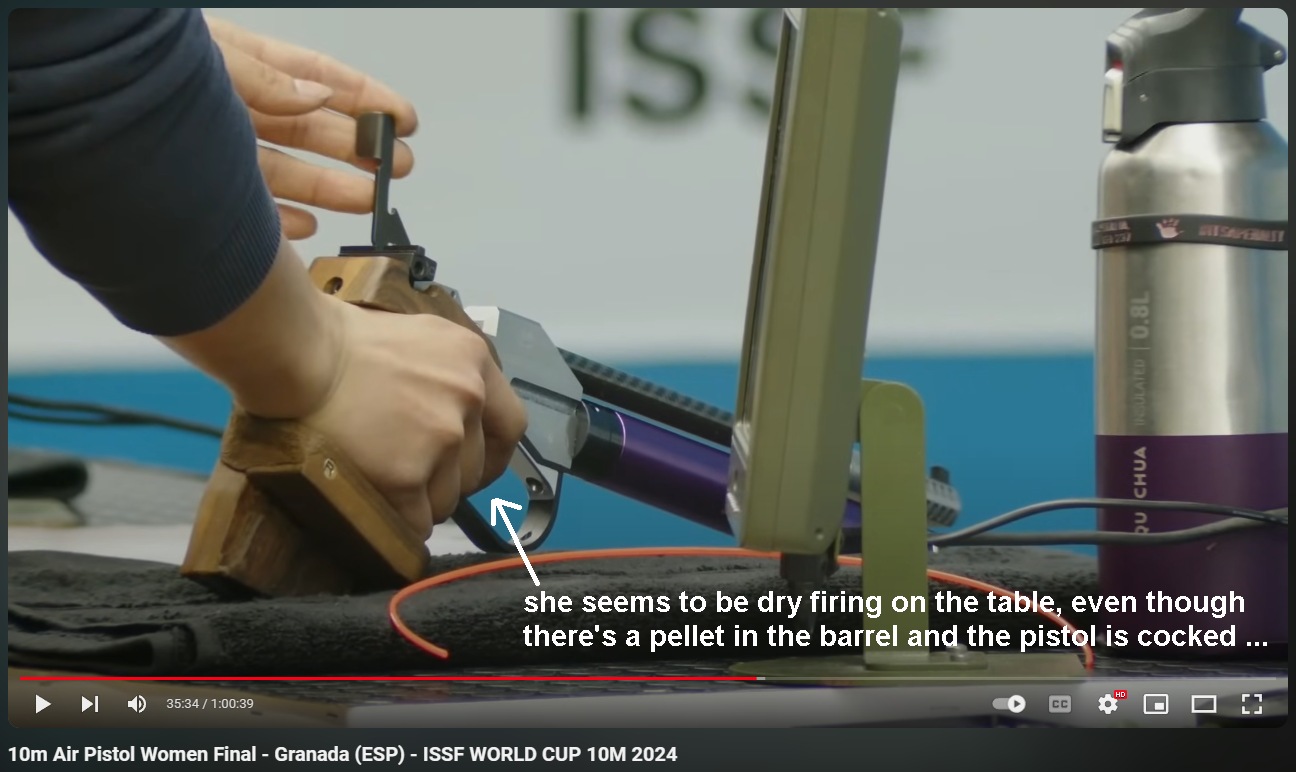

David M wrote: Wed Mar 27, 2024 2:56 pmDO NOT fire the trigger with the lever fully open, it will release the sear and the hammer spring will thump the loading block.
This is interesting! The World Cup participant in this screenshot looks to be pumping the trigger, even though she has the pistol loaded and cocked (but cocking lever fully open). I also tried this myself, and I didn't feel any movement at all in the cocking lever. And when I listen, I don't hear anything else happening, except the solenoid clicking, just like when you dry fire with the cocking lever closed and the pistol not being cocked.
During the years 2006-2023, my CM162EI cocking lever actually was so "stiff" that it stayed very firmly in the fully open position, despite me pumping the trigger. But maybe that is not how it was designed to be?
