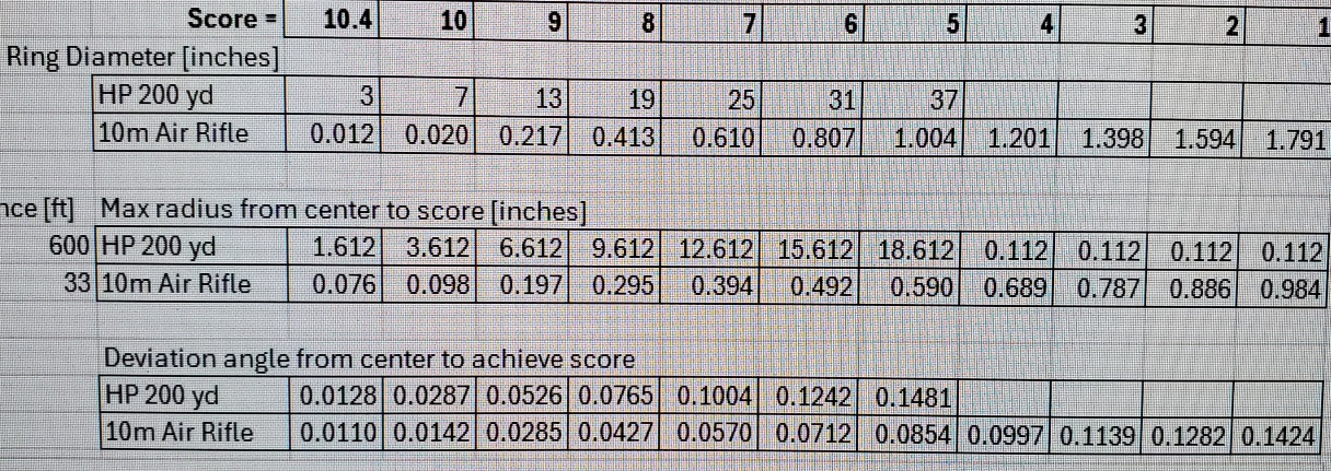

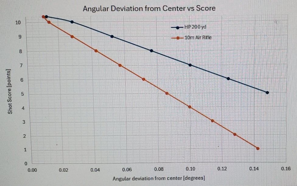

If I did the math correctly, then the bottom table shows the aiming deviation angle from center to achieve each score with a bullet that just contacts the ring. Assumed 0.224" HP bullet and 0.177" pellet...
Roughly,
- a HP 200yd standing 10 is an air rifle 9
- a HP 200yd standing 9 is an air rifle 7
- a HP 200yd standing 8 is an air rifle mid-ring 5
Roughly,
