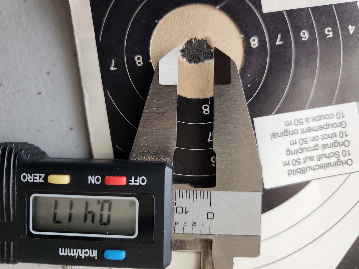

I have FWB2600 universal which is probably 25 years old. The factory 10 shot group is attached. C-to-C is 0.197. This brings me to a question: are currently made rifles shout any better? Would love to see currently produced factory target pics measured. I understand the ergonomics part, but pure barreled action performance is of interest here. Thanks

First the factory test target really isn't relevant after 25 years: it was shot with the barrel clamped in a vice, and is really a function test/proof the rifle meets the factory minimum standard, than a pure best accuracy test. The group you get is also cherry picked, FWB will likely have shot several, but only put the best in the manual. So, it was not shot in a way that represents normal shooting, with ammo that's not available to you, and you don't get to see what the others are like.This isn't to say that your FWB is inaccurate, but the test target is not proof of much after so many years.
Regarding newer rifles, everyone I know with a new short (possibly more rigid) action finds it nor fussy over ammo, and seem to shoot well with more batches than others. Your single factory test group might he slightly tighter, but a new Bleiker, G&E, or KK500 might be easier to feed today.
