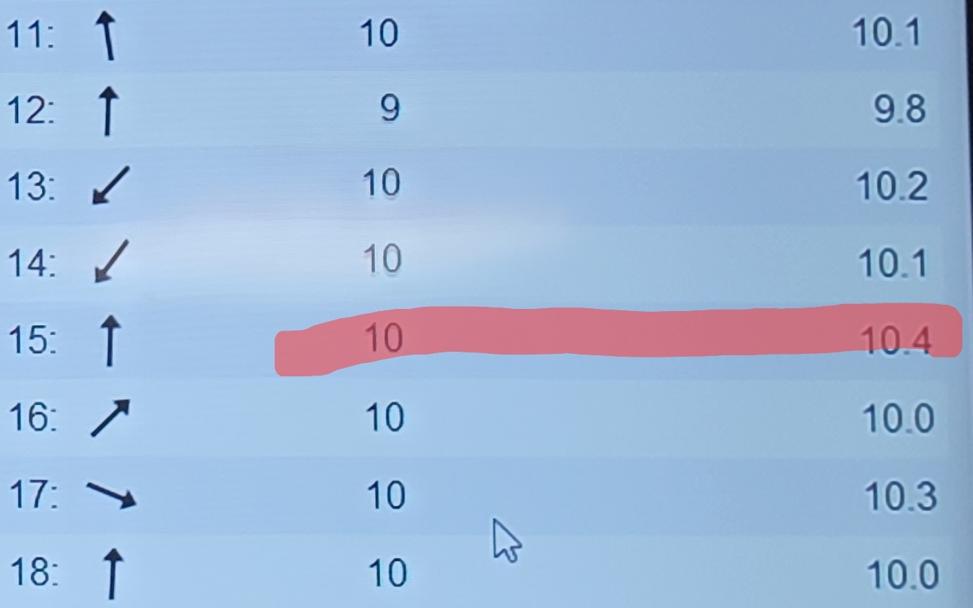

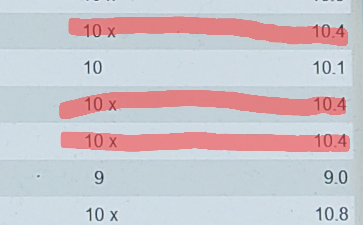

The annoying thing is that the Xring, does not coincide with 10.5 (Correct me if I'm wrong).

Yeah, the X ring for air pistol is somewhere around 10.41 or 10.42. It doesn't exactly correlate with any decimal score.
