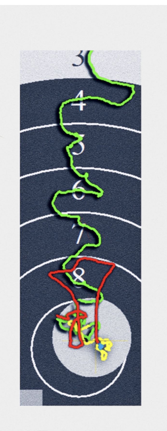

How to obtain such a curve in air rifle 10m??
loadcc
Posts: 23
Joined: Tue Nov 07, 2023 3:19 am
Location: CHN
Post by loadcc »

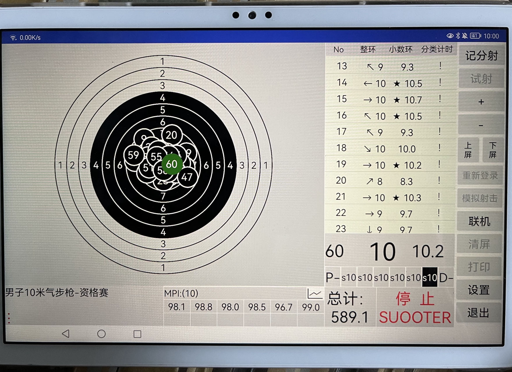

How to obtain such a shooting curve? aim at a point above the center, hold breath, stabilize, exhale, aim down, aim at the center, stabilize, and shoot. Is that so?
hope to get any suggestion from u.

Re: How to obtain such a curve in air rifle 10m??
Post by KabalMSU »
Training + clothes.

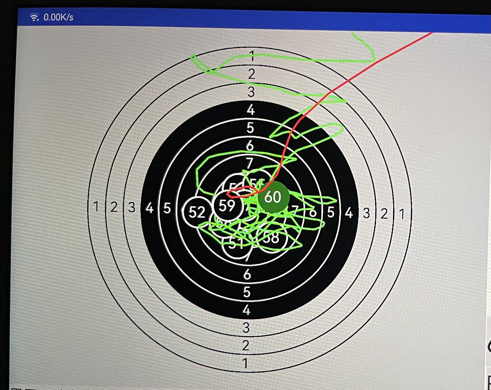

loadcc
Posts: 23
Location: CHN
Post by loadcc »

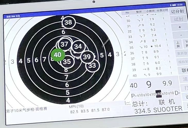

my curve,what's the problem and how to train.??

KabalMSU
Posts: 14
Joined: Sat Feb 25, 2023 11:14 am
Location: Germany
Post by KabalMSU »

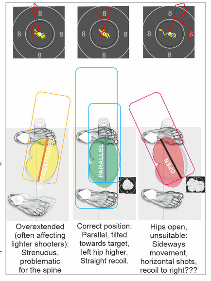

You force the muzzle into the middle - your trace comes from top right and recoil goes there then. The trace in your first post is defined by gravity only.
Post photos of your stance here.

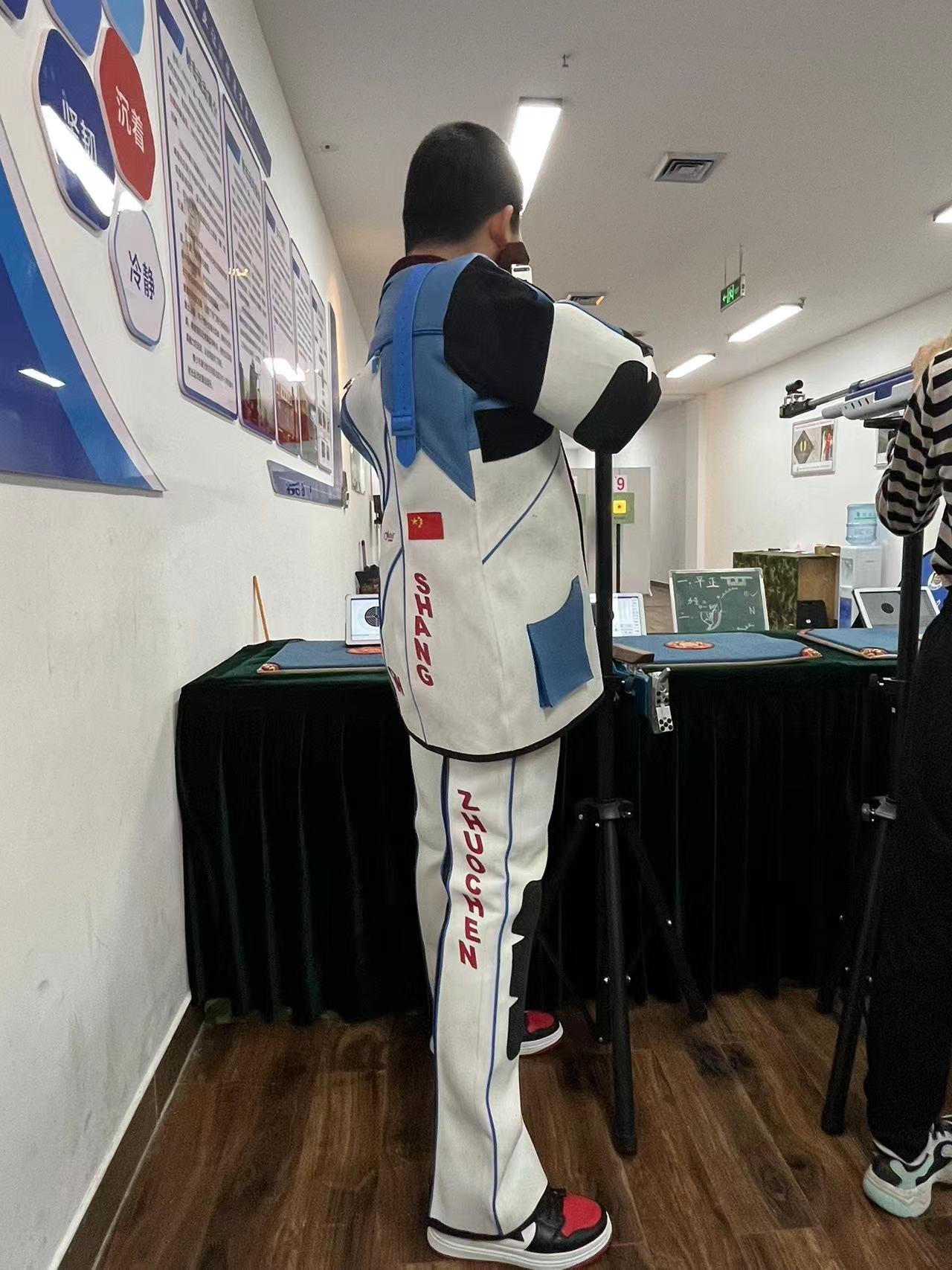

KabalMSU wrote: Thu Nov 16, 2023 4:24 am You force the muzzle into the middle - your trace comes from top right and recoil goes there then. The trace in your first post is defined by gravity only.
thanks for u tip's, i take a stance photo and find a hips twist.i will fix my position and see what's change in the curve.

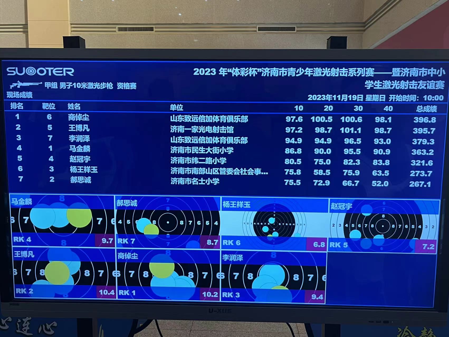

Since able to stand still, I will definitely find a way for me to hold an air gun without moving, but it will be different for each person.gun should suit for shooter,NOT shooter suit gun.
Based on this idea, I won a friendly competition between primary and secondary school students yesterday in my city with 396.8 score in 40 shoots.i use 8 breath in the competition,3 in off-hand\2 in hold gun\1 set the face and aim in bull\1 for hold and shoot. take about 30 minutes for 40 shoots. it/s seem work for me.I spent the first 5 minutes of the game searching for my NPA,AND USE “sway”。competition with laser device。
i browse MEC site yet , but it is also too expensive for selling book, especiall the high deliver fee.
by the way, youtube\facebook....... not available in my area.so this site is very good for me.
