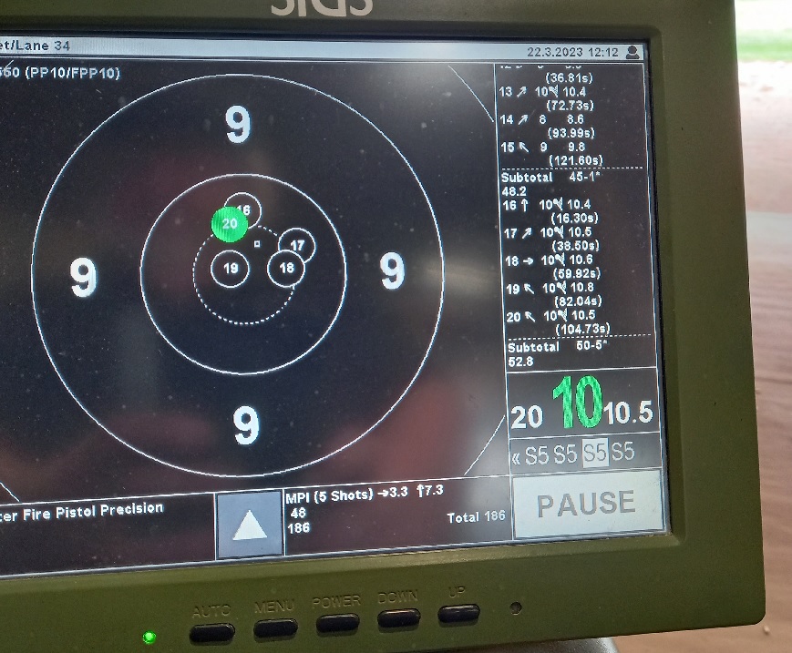

The most competitive .38 is the Manurhin Match Revolver.
Shot recently in a local competition with .38 wadcutters.
