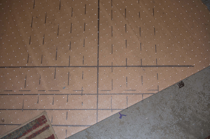

I've attached a picture of my Rube Goldberg grid which works for me. It is cardboard with a plastic office mat on top. I shoot three targets horizontally aligned, so the various lines make a foot placement pattern repeatable. The other marks locate my shooting tripod for each target position. This is for 10m rifle shooting, but works for pistol as well. Contrary to the previous post, moving a foot placement pattern as little as a few mm will move a group a complete ring, without otherwise changing my CG , sights, or other aspects of position.

Addendum to my previous long winded post...I shoot rifle left eyed and left handed, explaining the layout of my shooting mat, which would be unworkable for a right handed shooter. A mirror replica would be required.
