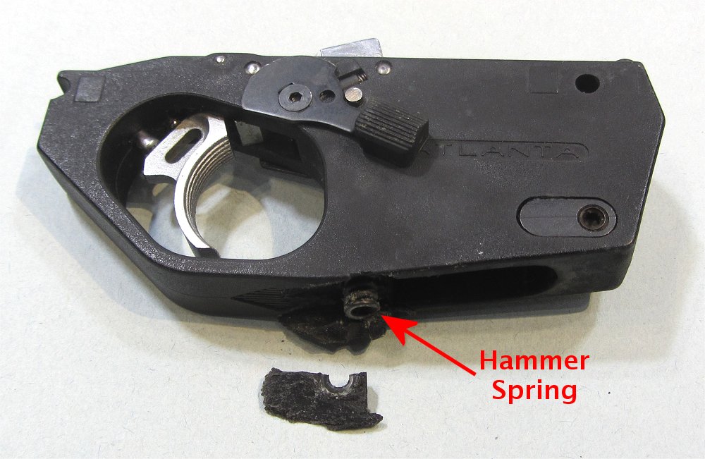

In theory, and to first order, perhaps. Reality is different. "Relaxation" in steel coil springs at lower temperatures does exist:
https://www.rockfordspring.com/relaxation-of-springs
I've seen a lot of pistol springs that come out of an old pistol that are shorter than when new. Whether it's from initial "set", over-stress due to poor design, excessive compression cycles, or relaxation is impossible to tell. It's also not just the spring that is a concern; the spring is being held by other parts. Here's what happens when you leave Benelli MP95E's cocked for many years:
It doesn't hurt anything to leave expensive target pistols in an un-cocked state when stored for long periods of time. The older the pistols, the more difficult is is to get parts, so I choose to treat them as gently as possible.
