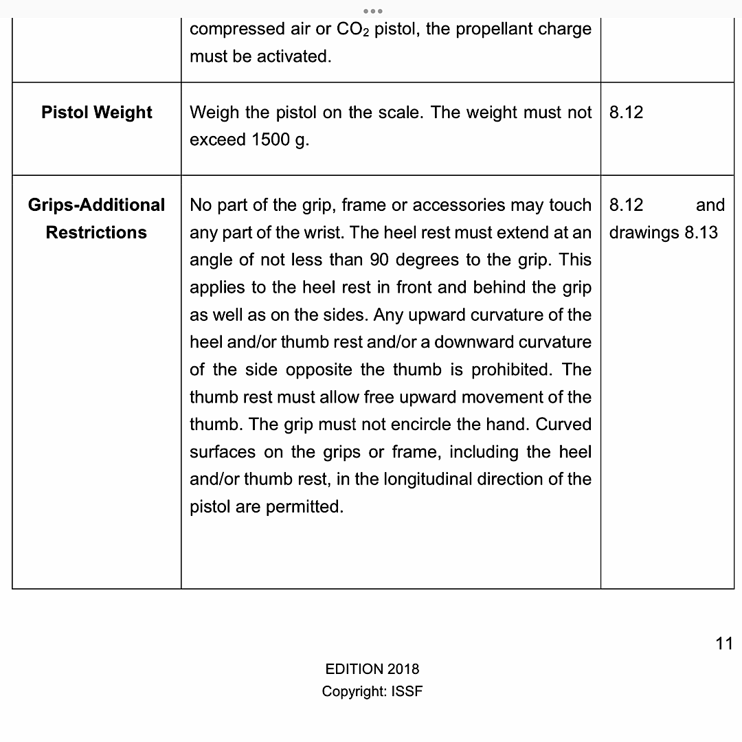

Cvb wrote: Fri Aug 12, 2022 1:02 am I couldn't find it in the rules.
Can I add or remove extra weights middle of the competition?
For air pistol finals, if the weight of the pistol was over 1500g during the match, and ended 1500g, or less, by the end of the match- in compliance- that would be a problem.
Look at page 11, in the following.
https://www.issf-sports.org/getfile.asp ... n_2018.pdf
