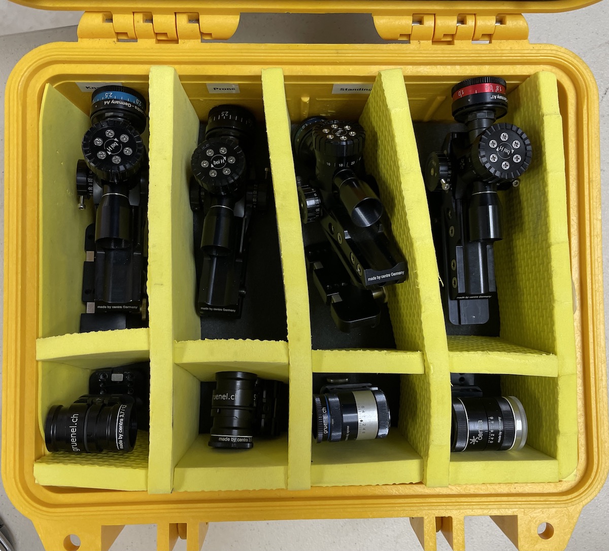

I would go would with Centra Spy (compact both in usage and transport, as well as being a little more economical if you are buying one for each position), or the Anschutz 7020 (with a little modification can be turned upside down). One thing folks forget with any of these is to clean and maintain them - be sure you add that to your list of things to do.
(Below) The sights we purchased from Mark Trew over a 1 yr period for 3P and Air.
