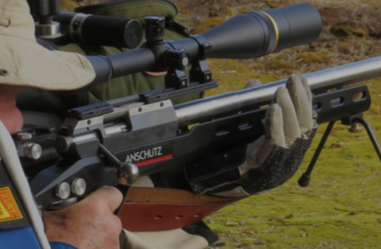

I've seen a couple. Here's an example from the 2022 ASSA Nationals. This one is sitting notably higher in the stock that others I've seen.

I know that rifle setup well.
It's actually a Benchmark 3 groove 16 twist barrel, chambered with a Nevius Chamber.
The KK500 action was set into the 2018 Precise stock using an Esprit Carabine adapter.

...I take good photos....;-)

1813benny wrote: Wed Jul 20, 2022 2:47 pm ...I take good photos....;-)
Confirmed!
