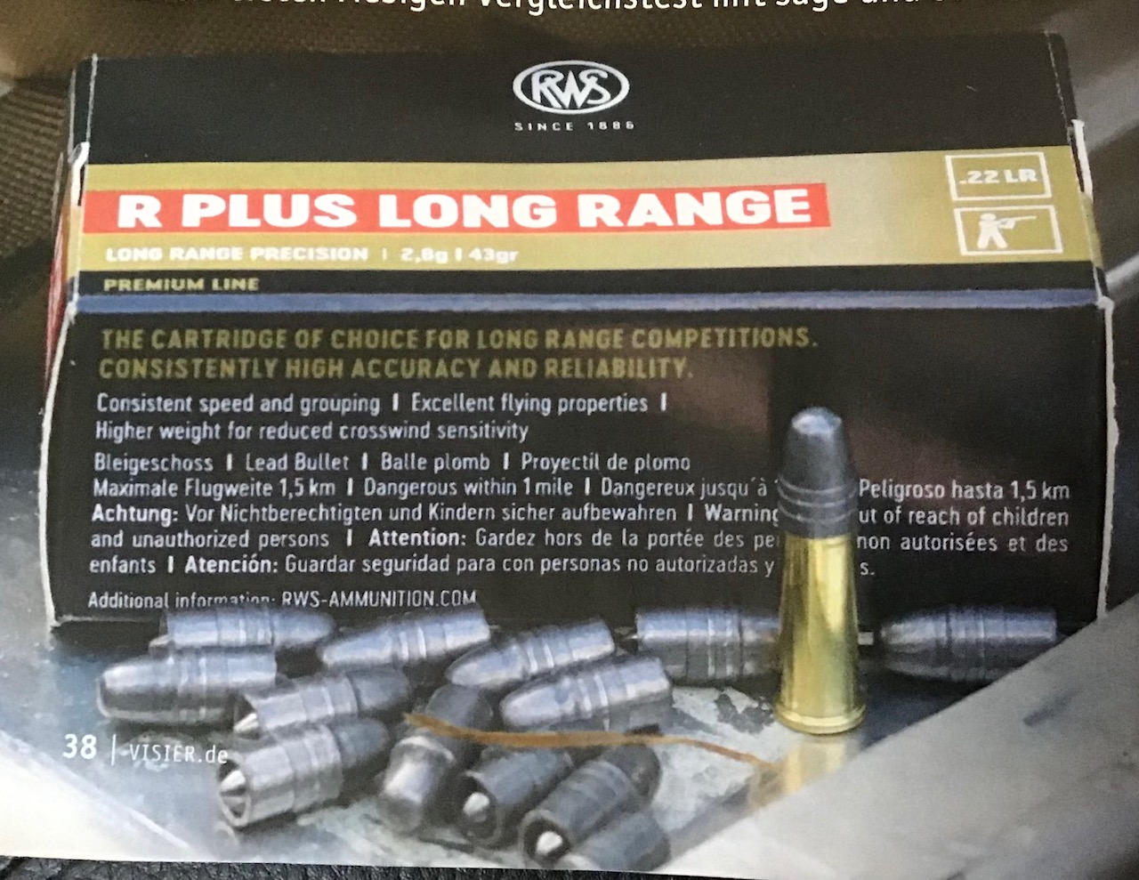

Post by Th. »
Besides the R100 RWS comes with an other round for long range
