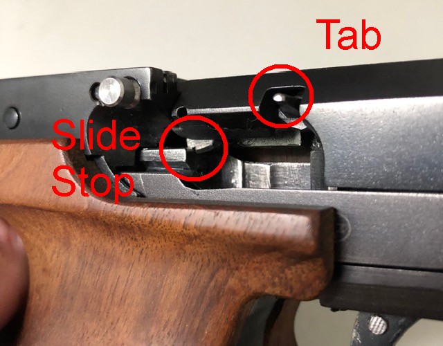

I think you can see it here
https://www.rstradehouse.com/item?id=100210134512&l=id
Guns I've seen have a spring loaded tab to stop the round going above the chamber, it also slows the slide a little.

Leon wrote: Thu Mar 31, 2022 12:40 am "The MP 438 has a tab which may slow it a bit, I can't find a picture."
Hmmm - I had a MP438 and don't recall seeing anything like that.. I'll ask the current owner to have a look..

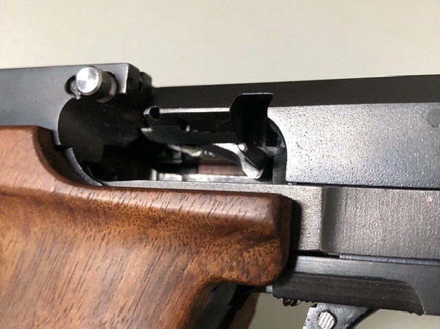

The tab is attached to a hinged, shaped bar which serves two functions: when the tab (actually a spike) is up it introduces a slide stop at the rear of the "bar" (first pic); when down (with the slide back) the shaped part at the front of the "bar" helps guide the next round into the chamber rather than allowing it to tilt up and hit the breech, as JamesH mentioned.

As the slide goes forward I think the slide has to lift it out of the way, then it drags on the top.
How significant this is in reducing slide impact on the breach face I don't know.

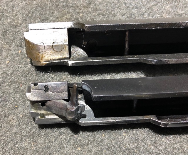

BobGee
Posts: 590
Re: IZh35M going full-auto..
Post by BobGee »
Better pic of the shaped bar/slide stop. Top IZH-35M, bottom MP-438.
