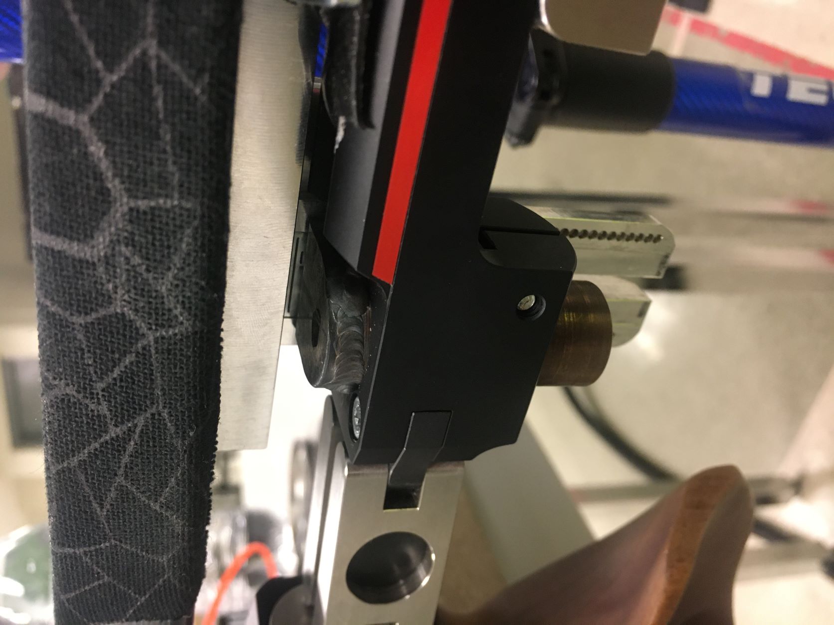

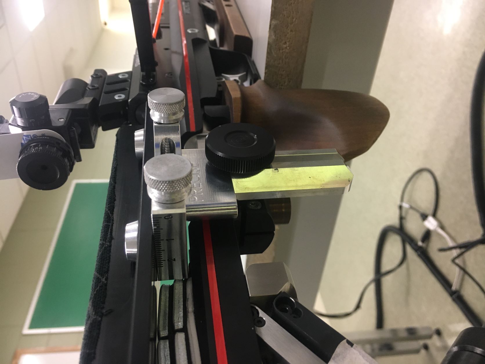

Hi all,
Just trying to gauge some interest. Recently I designed an adapter allowing Anschutz 9015 ONE shooters to switch to the use of the Anschutz precise cheek piece. I did this for a friend and she loves the adapter saying it greatly improved the feel of the gun and solved the main gripe she had with the stock. I'm considering manufacturing and selling these. The unit is made entirely of steel (Robust TIG welded construction), and requires no modification to the existing stock for its use. They'll be made to order, so I can also take requests for custom offsets, weights, or different construction elements. They will be finished in graphite black Cerakote. I haven't decided on a price yet, but I'm currently thinking around the $150 range.
Thanks for any input.
Re: Anschutz 9015 ONE Precise Cheek piece Adapter
Would be great if you posted some photos of it.
It is just a gauge interest post, but in initially didn't post any with it as I was kind of under a time crunch to get it out the door so a teammate could use it in her match, so taking pictures wasn't really on my mind. The current prototype out in the world is fully functional, but relatively crude in form finished product would be close to the same but with prettier welds and better surface finish. I'll grab some pictures to post on Monday.
- Posts: 20
- Joined: Sat Feb 29, 2020 4:42 pm
- Location: Akron, OH
Here's a couple photos of the prototype adapter installed. Unfinished but fully functional. I plan on finishing it in a week or two after the NCAA season ends. I do also have a few updates to the design in mind. I'm going to update the front guide surface the cheekpiece rides on. currently the adapter uses a stud and guide pin to keep the cheekpiece aligned vertically, but I would like to change this to a milled keyway. this will improve the stability of the cheekpiece. The second update is the addition of a captured ball detent, which will add the tactility back to the height adjustment that is present on the normal precise stocks.
