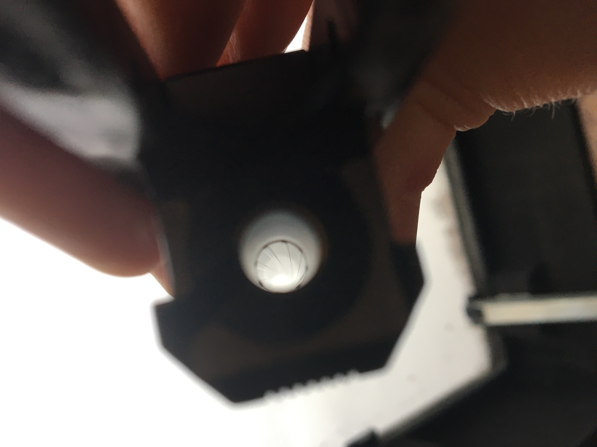

I use an angled chamber bronze brush every 500-750 shots, but a nylon and pull through every session or two, and the barrel looks spotless. I could use some heavier cleaning product than balistol, to take any metal build up away, but I see no signs of any not even a single flake when bronze brushing.
yep, if this was random fair enough, but I feel there's too much consistency to be a dirty gun.
I'm having trouble to take a pic of the chamber, but its very smooth, very clean, no flakes after bronze brush.

If you don't have a borescope, you can't really see how much fouling may be in the chamber. My regular cleaning protocol sounds similar to yours, and I still had enough carbon built up that it affected things. I've checked several problematic Benellis the team I help coach has, and they all have baked on carbon in the chambers.

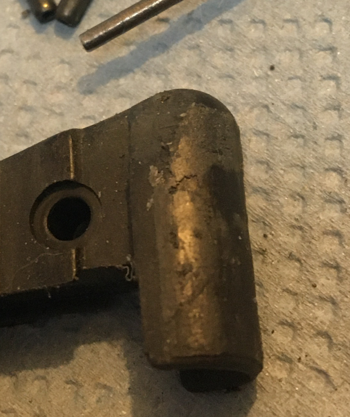

I was met with this when I took apart the magazine today, as well as a hard to see buildup on the inner walls of the magazines which I scraped off with a blunt wooden saté stick then got the rest with a thin toothbrush. I'll get to test tomorrow at the club, I'm thinking this might just be the issue. Magazines only ever got a minimal clean, so I'm glad I dismantled it. I can order a couple of new followers from Sweden, even when clean these aren't as smooth as I think they could be.
Posts: 3566
Re: MP90s last round issue
Yeah, that looks like it could be an issue...
If you don't have a disconnector lever, and the pistol doesn't go click, then the bolt is not coming back far enough to cock the hammer. That means there's too much drag someplace. The only thing I can figure is that the magazine is so crudded up that it's adding drag, but I'm not sure how/where.
The Benelli magazines aren't the easiest to work on. I will occasionally push the follower down & scrape out accumulated lube & fouling. They will usually behave for over 10K rounds before they need a full disassembling. If you take one apart, you only need to remove the rear roll pin. The only tricky part is getting the roll pin properly lined up with the hole on the far side when you reinstall it. I much prefer the Pardini design, which you can open up in seconds with almost any small pin/punch/toothpick, etc.
It certainly won't hurt to have nice clean magazines. Hopefully that will fix it.

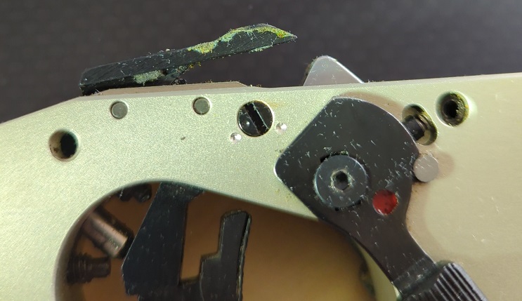

On the older ones, the locking grub screw and the marks are on the left side, not the right.
MP90S 1st Stage Length Adjustment Cam & Locking Screw.jpg (21.16 KiB) Viewed 3133 times
"H" is the grub screw.
