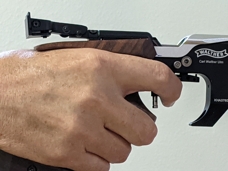

I have owned a few APs. My first was a Pardini. It was a constant struggle with the grip and trigger position trying to get it into as neutral a position as possible. I had to forced my wrist over so far that on shot release my hand +wrist would bounce up under the tension and the trigger position was a strain on my trigger finger. My second was a Steyr Evo 10E. The same problems. There was not enough adjustment to fit me. Then I tried a Walther LP500 at WAG a few seasons back. There was enough adjustment in the 3D grip and trigger placement to eliminate most of the issues. Sold the others. I however, still see a little upward movement on shot release due to upward trigger pressure with a relaxed grip. This I compensate for with more grip pressure and holding that through the shot release. This all would disappear with a straight back trigger.... i think. Too bad there is not a US made Olympic class AP. A picture is attached showing my setup.
Posts: 1718
Re: AP with straight back trigger rather than pinned
Looking at the grip, it appears that you are using the least amount of rake with grip tilt.
This is forcing your trigger finger up into the trigger bar.
There is a big difference between American and European pistols is the grip angles.
American pistols tend to have a upright grip angle, good example is Colt 1911.
European pistols have a lot more rake angle with the extreme being a Free pistol.
I think you need a custom grip with less rake angle. This will raise the pistol in your
hand with a higher barrel line and lower the trigger finger position to more inline.
Try an experiment with a spacer of 3-5mm between pistol and grip to lift the pistol.
It may not fit the box, but will show you if the change will work.
Posts: 3566
mhayford45 wrote: Fri Nov 12, 2021 3:13 pm I have owned a few APs. My first was a Pardini. It was a constant struggle with the grip and trigger position trying to get it into as neutral a position as possible. I had to forced my wrist over so far that on shot release my hand +wrist would bounce up under the tension and the trigger position was a strain on my trigger finger. My second was a Steyr Evo 10E. The same problems. There was not enough adjustment to fit me. Then I tried a Walther LP500 at WAG a few seasons back. There was enough adjustment in the 3D grip and trigger placement to eliminate most of the issues. Sold the others. I however, still see a little upward movement on shot release due to upward trigger pressure with a relaxed grip. This I compensate for with more grip pressure and holding that through the shot release. This all would disappear with a straight back trigger.... i think. Too bad there is not a US made Olympic class AP. A picture is attached showing my setup.
If you look at the photo, your trigger finger is at a very different angle from the rest of your fingers. I know you are hung up on trying to pull straight back, but you might find it a lot more natural to move your trigger down on the rod so you aren't pulling at an angle compared with your other fingers. I've never seen anyone set up their trigger so their fingers are splayed that far apart.

Gwhite wrote: Fri Nov 12, 2021 7:33 pm If you look at the photo, your trigger finger is at a very different angle from the rest of your fingers. I know you are hung up on trying to pull straight back, but you might find it a lot more natural to move your trigger down on the rod so you aren't pulling at an angle compared with your other fingers. I've never seen anyone set up their trigger so their fingers are splayed that far apart.
This is exactly what I had to do with the K12. Lowered, extended, and slightly canted the trigger shoe. Huge difference in aligning the fingers more naturally (for me anyway).
The stock L K12 grip just didn't work for me either - the XL Rink really changed the entire dynamic. It yielded a different more comfortable rake, more natural wrist angle, and a better fitting (& more adjustable) shelf. Now I can let the pistol basically 'sit' in my hand while exerting almost zero pressure anywhere. Holding seems to be more stable and infinitely less stressful.
