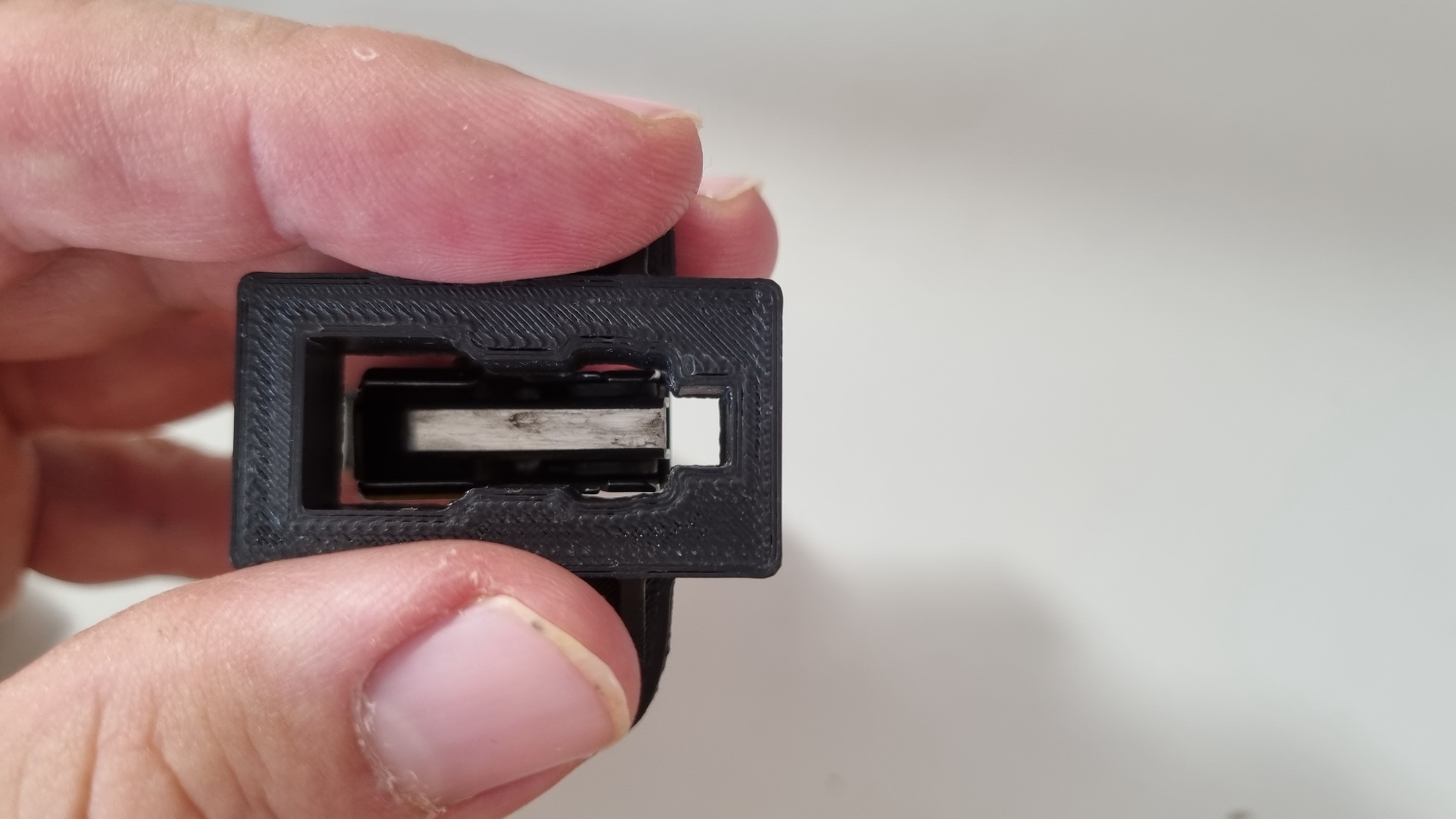

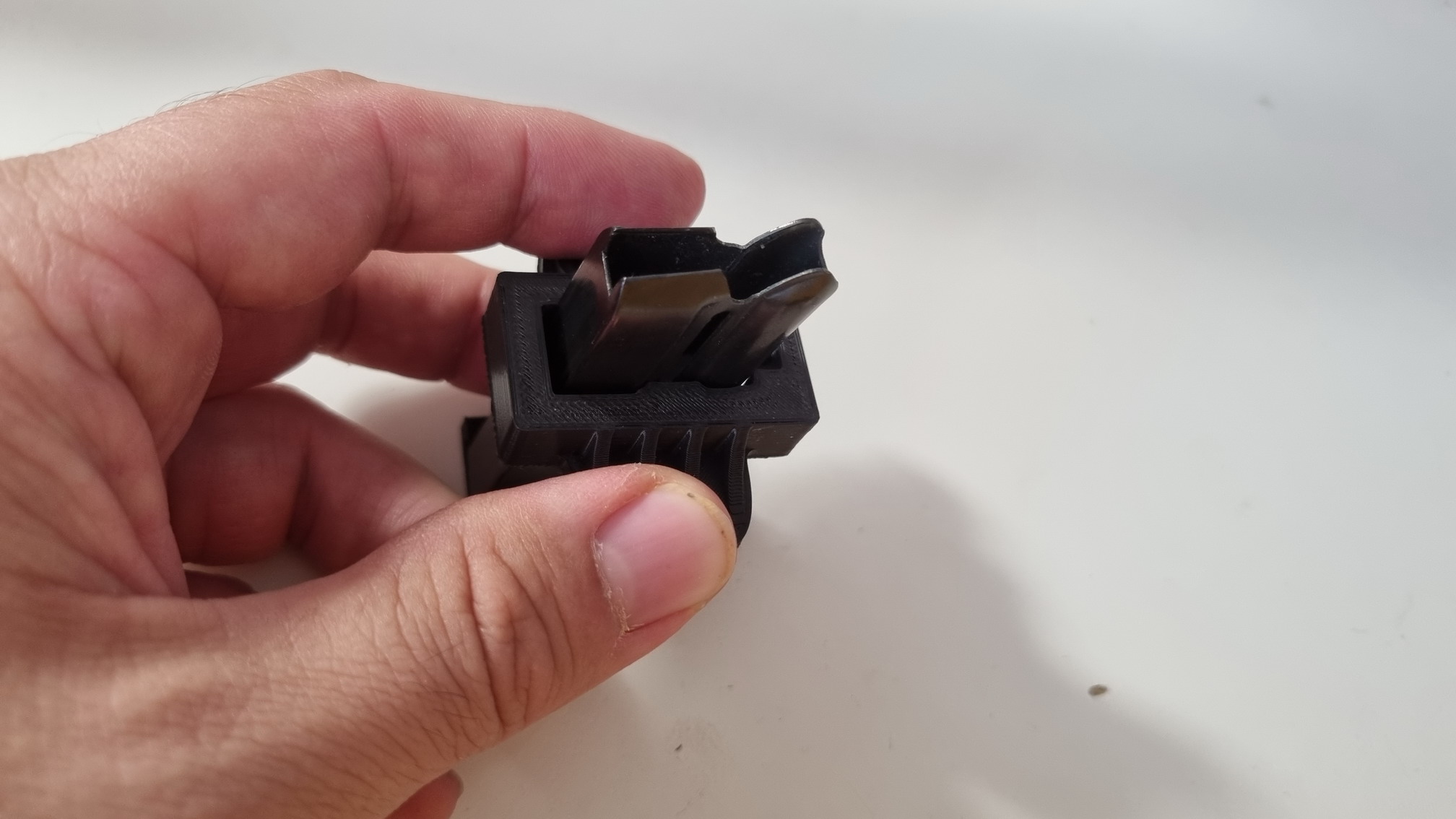

printed one. works great for the 22LR mag
however, it does not fit the 32S&W mag
@Gwhite : can you modify the 3D model for 32S&W? please :)

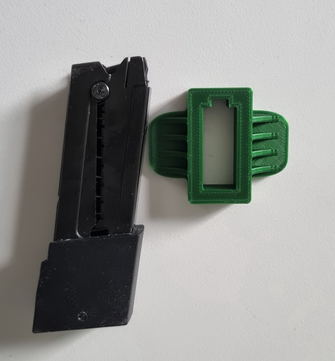

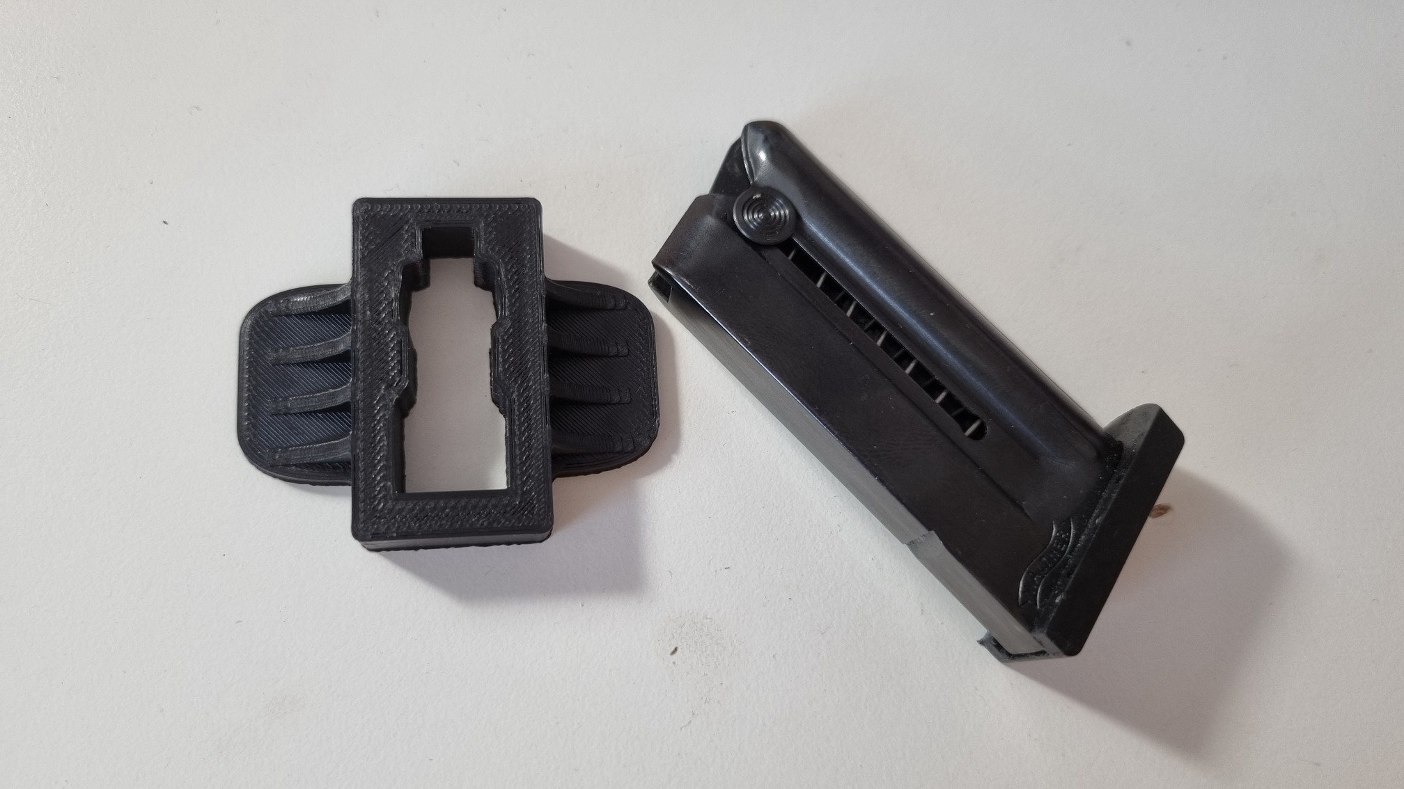

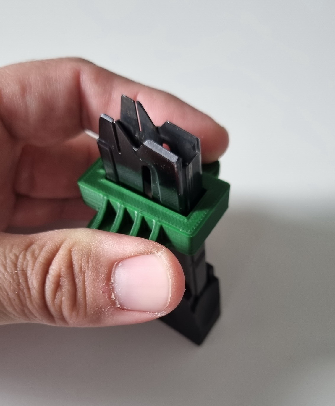

Posts: 451
Re: Walther GSP speeloader
managed to modify gwhite's model to work with Walther GSP .32S&W L WC magazine
32Loader_v2.zip
(13.31 KiB) Downloaded 117 times

Posts: 451
used both of the loaders (22 and 32) today and they worked very well.
loading a magazine is far easier and faster with a loader.
