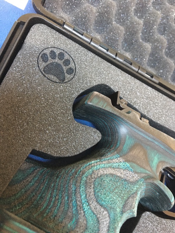

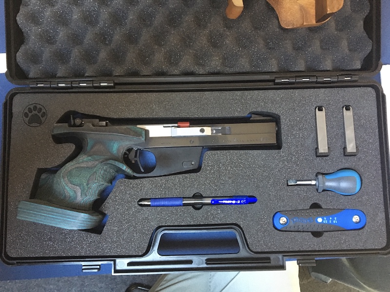

For the main part of my case, I use an inch thick EVA-50 foam. Egg box style foam on both sides just makes for too much compression on the foam and over time, it just looks bad. After a year, there isn't a mark on it, or even a tiny area of wear.
I laser cut mine, it results in clean and sharp lines, less pressure on the case and hinges especially with match grips since the pistol sits 2.5cm lower than before.. It also means the case can always be a little more organised with no chance of a magazine or tools rolling around on the pistol.
It's not for everyone, and I'll redo the design now that I've had it a year and put it in case thats not so wide.
Under the foam is a high quality 1cm thick blue yoga mat piece, which I also use on my workstation table.

This first one was done by a company in Haarlem with a laser, before I got my own 700x500mm bed 80W co2 laser, and I ran the next one myself.
It fits a medium Rink, and the original Large walnut is a little more snug. I did the vector layout for the cut myself, and you are welcome to the svg file any time. the EVA 50 is great, firm but has plenty of "squishiness" left. Has been very resistant to Remoil, Balistol and general grubbiness of the pistol and magazines.
