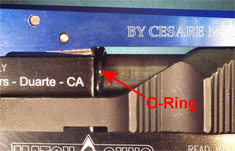

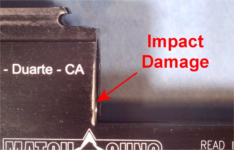

Apparently I wasn't entirely clear on where the O-ring slide buffer goes. It goes on the front of the middle section of the frame, so the back of the front of the slide doesn't slam into the frame there.
Before I installed the O-ring, there was visible damage from the inner corners of the slide hitting the frame:
Here's where the O-ring goes:

Super clear; thanks!

Thank you for posting the O-ring placement it was driving me nuts trying to figure it out in the manual. I just took apart mine after 500 rounds for a cleaning. Actually surprised with how simple it was !

The factory is constantly tweaking things, and the manual frequently doesn't keep up. The manual I have shows a square flat buffer with holes punched in it, but that is from an earlier version. I could see where my slide was hitting the frame, and the US importer and I came up with the O-ring idea as a replacement for the buffer.

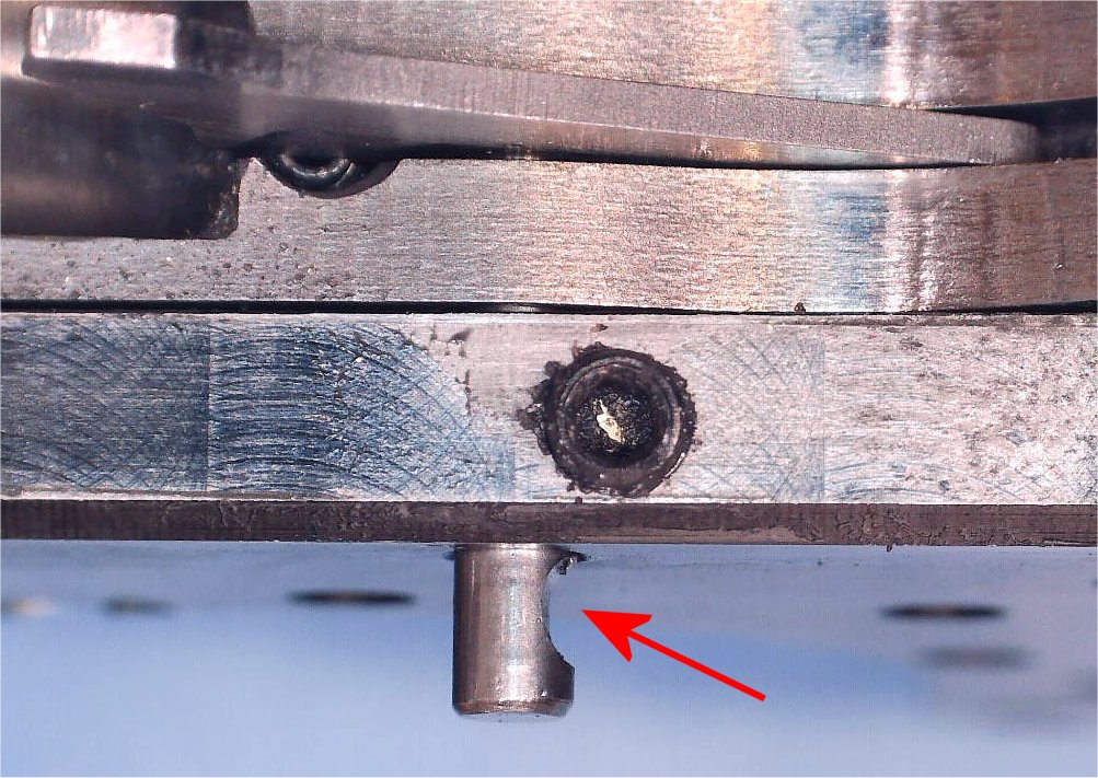

I've got ~ 15000 rounds through my MG2 now, and have always done just manual cleaning. One thing that might help feeding issues is to take the carrier out to clean down inside the frame and relubricate it. When I first did that on my wife's, I also found a burr around one of the carrier detent holes inside the frame that was potentially causing issues.
Removing the carrier isn't too difficult if you are careful. You unscrew the small set screw (#2070) that locks the carrier pivot pin (#2042A) in place. It's in the top of the left frame rail. You don't have to remove the screw, you just have to back it up enough to clear the notch in the pin. Push the pivot pin slowly out to the right, while hanging onto the ejector. It will pop up a bit when the pivot pin clears it. Don't lose the ejector spring! Pull the pin out until the carrier is free. The carrier will be tight because of the two detent balls/springs, so you may have to wrestle a bit to get it out.
Clean everything, and lubricate the frame where the detent balls ride with a bit of grease. Oil everything else & reassemble. Other than compressing the detent balls to get the carrier back in, the only tricky part is the locking screw & the notch in the pin. Push the pin so it sticks out far enough on the left to get the notch vertical, and then slide the pin back into place.
The set screw screw does NOT clamp the pin, it just fits into the notch to keep it in place. The screw only needs to be gently snugged so it won't work loose. Do NOT get carried away with tightening the set screw, or you run the risk of stripping the threads.

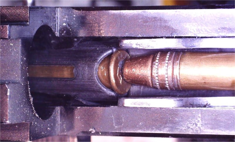

The MG2 feed system is brilliant, but the length spec on .22 LR ammo has a huge tolerance range, and that can cause problems. The SAAMI spec for overall length is 25.4 +0/-1.27 mm. That's a full tenth of an inch of possible length variation, all still within spec. CCI tends to run between 25.0 and 25.3 mm. The Aguila I've measured runs between 24.6 and 24.9 mm. Wolf (made by SK) tends to be shorter, but a bit more consistent (24.50 to 24.7 mm). I measure some SK Target Pistol, and that was a bit longer, running between 24.7 and 24.9 mm.
On my pistol, the original ejector held the cases forward quite a ways from the back of the carrier. That worked fine with short ammo like Aguila, but longer CCI rounds caused jams with the last round. The magazine spring doesn't holding the last round back with much force. Under recoil, long rounds could slide far enough forward that the nose of the bullet was clipping the bottom of the barrel. Here's what a badly jammed round looked like:
Rnd 5 Jam 7-2-20 (sm).jpg (52.69 KiB) Viewed 5466 times
Even if it didn't cause a jam, it frequently chewed up the bullet nose to the point where I would get keyholing. The factory changed the ejector design so the rounds would sit back further, which mostly eliminated that issue. I haven't shot enough CCI (due to the ammo shortage) to determine if the jams have been completely eliminated, and if any residual bullet damage occurs with longer rounds.
However, with the new ejector, I started having issues with shorter ammo. The 1st round would sit back in the carrier far enough that the 2nd round would stick out the the magazine far enough that the rim would be caught as the front of the carrier swung up:
The carrier is under the rim of the 2nd round, and it has lifted the back up far enough that the round can't slide back into the magazine. Depending on the length, sometimes the 2nd round would slide back into the magazine, but occasionally it would jam and I couldn't get it to load until I released the magazine far enough to get the 2nd round out of the way.
I mostly fixed that by beveling the front of the carrier so that it would push the 2nd round forward, combined with a slight bevel on the back of the magazines. The factory fix was to redesigned the carrier so it is shorter in front. Once I got one of the redesigned carriers & installed it, the short round jams went away.
