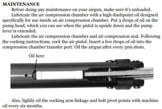

So here is the mystery. AV manual recommends frequent oiling:
I've checked the original manual, and it says to clean and lube bore after each shooting (no oil recommendation, so regular gun one assumed), anything else - as necessary, with https://www.ebay.com/itm/233721816752 or https://www.ebay.com/itm/324057651540. Both are greases, not oils.
The manual also recommends lubing piston cup if pumping is hard
What is going on with AV manual translation?

Another interesting difference - original manual says that dry fire is done exactly as real one, just without pellet (re: multiple discussions about danger of pumping for dry fire)

What do people think about the manufacturer's recommendation "clean and lube bore after each shooting" (probably the reason they include a rod in the set)? Do they know something we don't?
