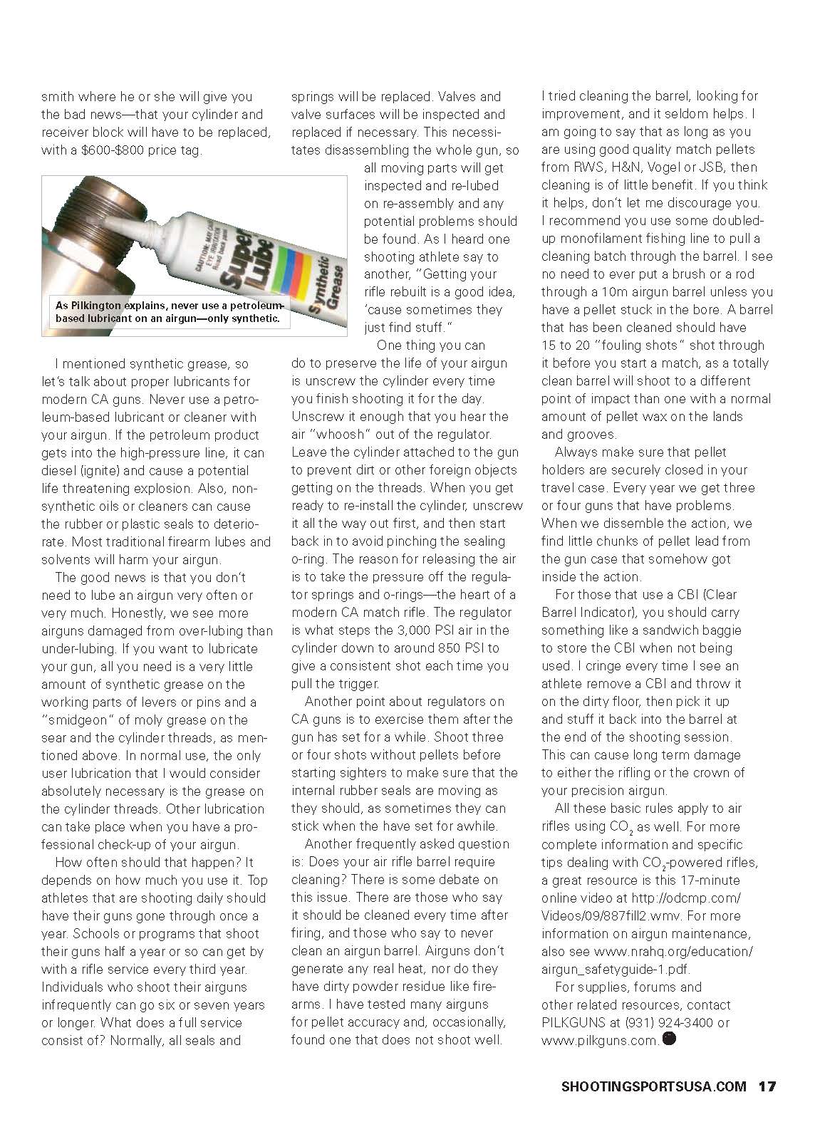

Use a non petroleum based grease.
Silicone or lanolin based on the threads only.
Most dive shops stock tubes of suitable grease.

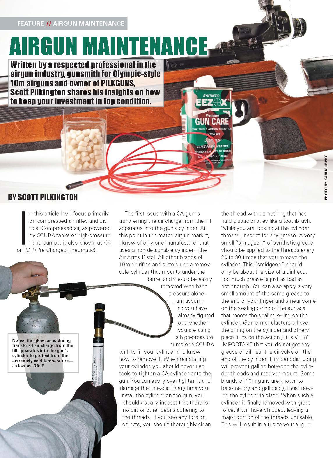

We use Super lube. Scott Pilkington wrote a great article on this, years ago-
https://www.nxtbook.com/nxtbooks/nra/ss ... .php#/p/16
*edited to add the attached files.

+1 for Super Lube use.

This:
SILICONE
NOT this:
Petroleum-based, which results in THIS:
If you INSIST on using lube - please use only a veritably microscopic amount.

I ordered the Super lube Silicone Lubricating Compound with Syncolon (PTFE) #92003, which is the one that is recommended above.

How often do you apply lube to the cylinder threads and how much?
The article recommends after 20-30 times the cylinder is changed and just a “smidgeon” – the size of a pin head. At each install you should be sure there is some grease. The manufacture (FWB) also says to check the cylinder for grease before reinstalling – otherwise grease slightly. Whatever slightly means.
Easier said than done. The manufacturers grease I use is clear and seeing such a small amount applied so infrequently is a bit of guess work. At least to me.
What do you do?
Posts: 3445
Re: Recommendations for Lubing Threads on a Morini PCP Cylinder
Things should thread on & off smoothly. At the slightest hint of drag or roughness, I clean the threads & relubricate.
