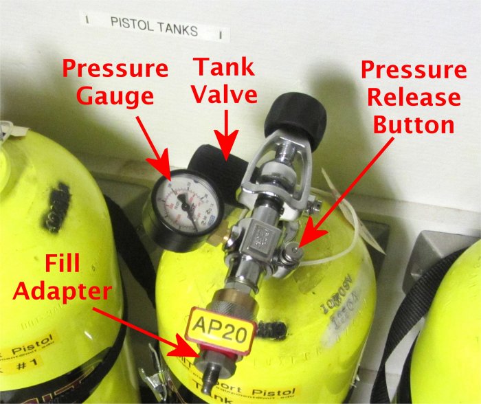

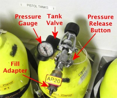

Posts: 3297
Re: Male to female DIN with bleed valve?
Here's what I think his setup will roughly look like. The team I help coach has three tanks with the Best Fittings gauge & bleed valve adapters set up for different air guns. Our tanks have K-Valves instead of DIN:
This one has a Hammerli AP20 fill adapter installed in the female DIN. I 3D printed label holders to identify which adapter is installed.
