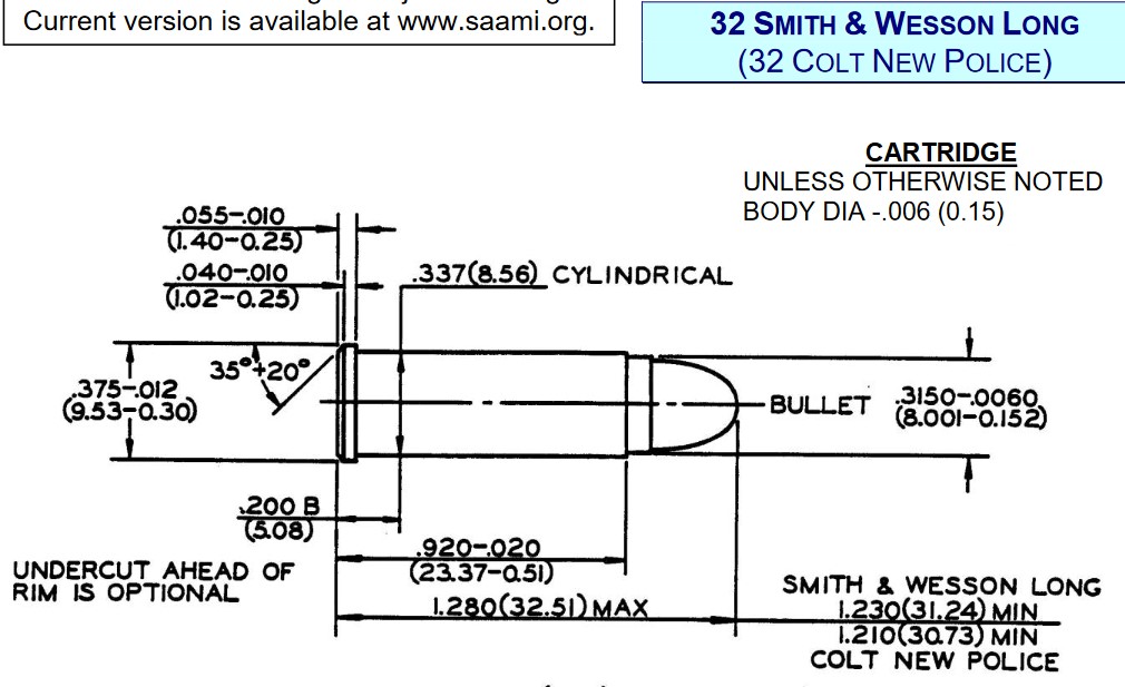

Bullet size for the .32 SW long is a bag of worms, it has the worst SAAMI spec of any cartridge.
Diameter is anywhere from .309" to .315".
Revolvers are Manurhin .311"-.312" up to SW .315"-.316"
Auto's are FAS .310"-.312" up to Hammerli .313"-.314"
Slug your barrel to find out the size.
Use soft lead bullets .001"-.002" over barrel size.
Check/alter dies to match bullet diameter.
Best of luck....

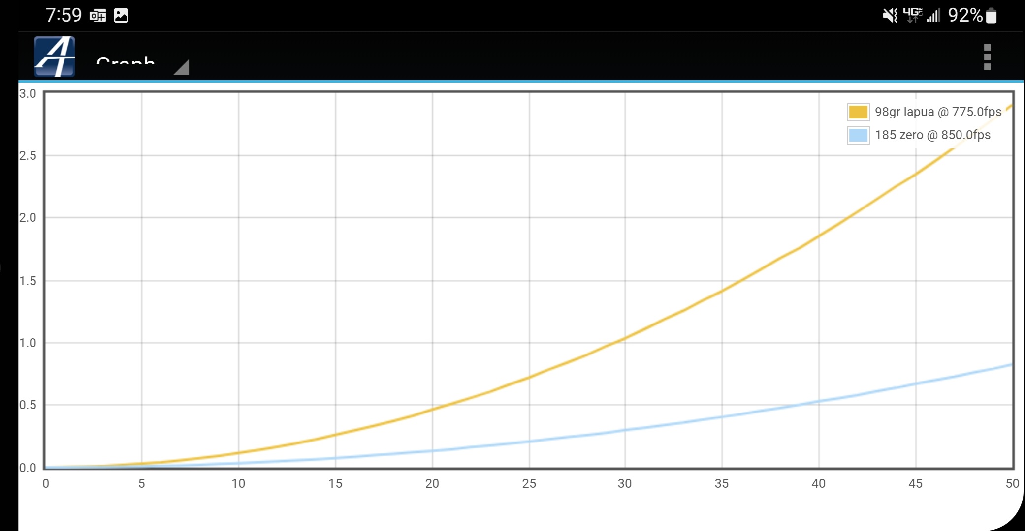

I really like shooting the 32 but to be honest you're really handicapping yourself if you're shooting the 32 outdoors. When I got mine I was also thinking of possibly shooting it for center fire, and listened to some older guys talk about how bad it was and drift. 1st thought was we don't worry about drift in Bullseye then I did some ballistics. With a 10 mile an hour crosswind on a 98 gr lapua at 775fps you're drifting almost 3 Inches in a 10 mph crosswind That takes you from an X to an 8 (9 ring diameter is 5.5" so 2.75 from center). And you have a smaller diameter bullet so you don't benefit from a bigger hole on close shots. Mat not seem like much, but the 45 is .13"bigger so you get 1/16 more scoring area. That's a lot thicker than the line on most targets.
Sure it's only 30 shots for slow fire, and not all will be affected by wind so let's say 1/4 (7 shots) are. You willing to give up 14 points on the long line to start the match?
The bigger issue to me is that it makes you start to question your calls. Ir even worse, blame wind for a bad shot that you don't want to admit.
It took me 15 minutes of ciphering to come to the conclusion that most high level shooters already know... shot 45 for cf...
