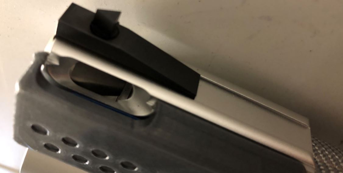

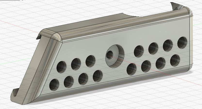

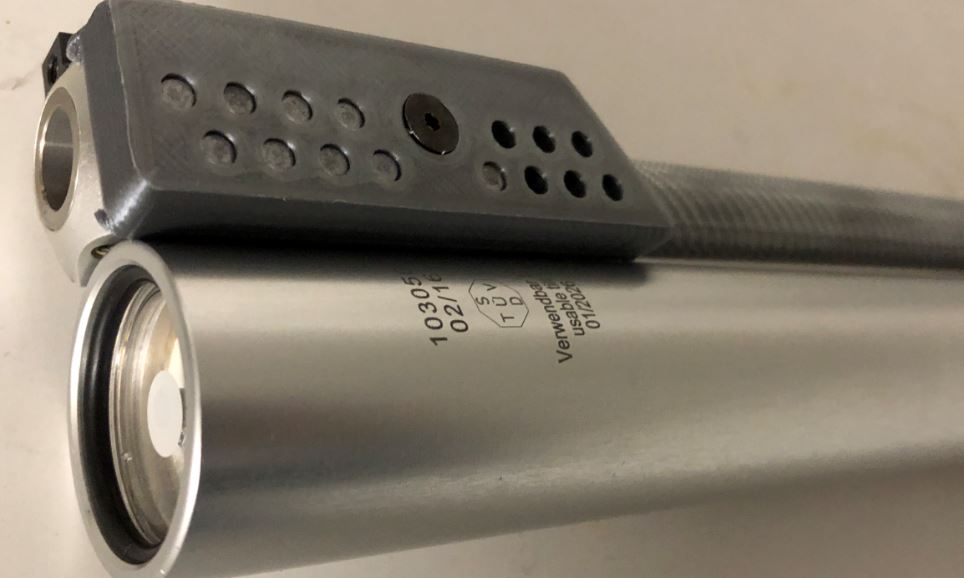

I designed barrel some weights for my Walther LP400. I can press fit pellets in several holes to add weight and adjust CG.
Not sure if its useful, effective, worth my time or even legal.
Appreciate comments

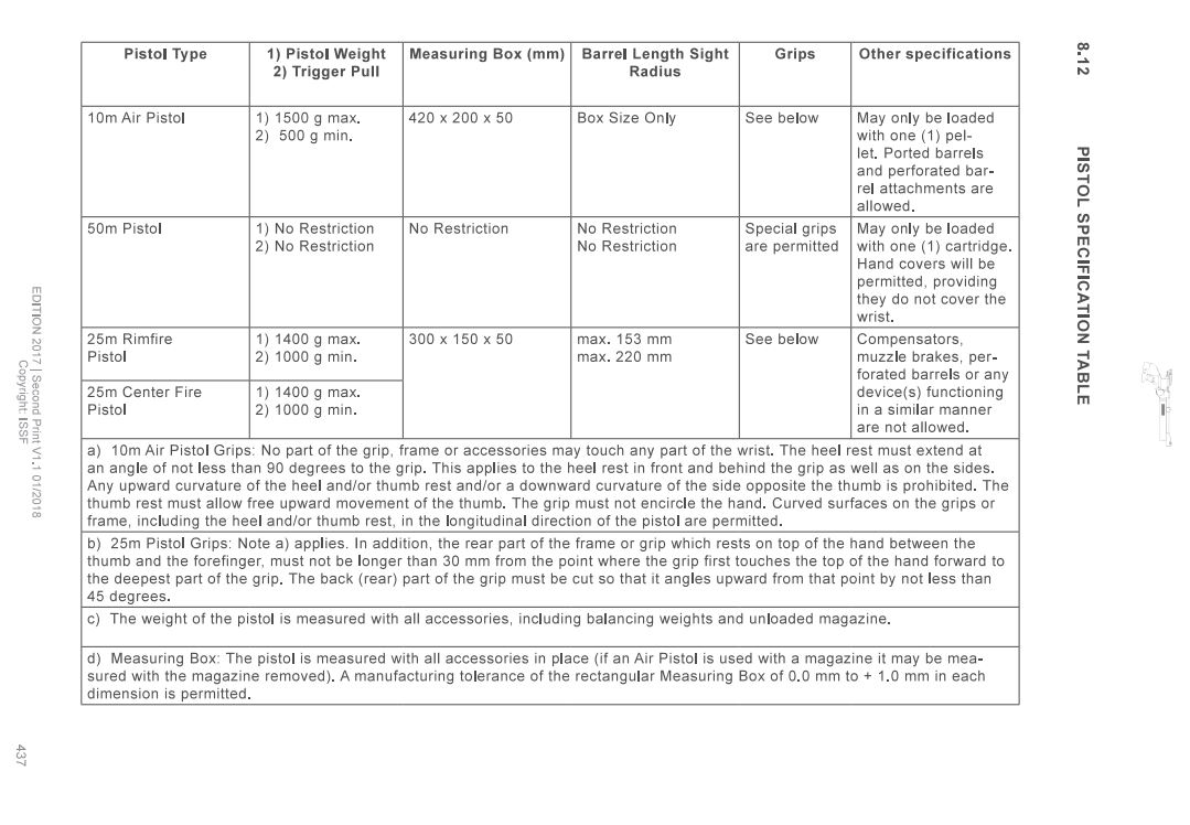

I'm resurrecting this topic, as i'm also in 3d printing and really don't get the crazy prices for barrel weights. Like, $30 for a 15g weight? What if i just make a diy 15g weight (i have a precision scale to check) and install that instead? Is it "illegal" to do so? I mean, they check the weight of the entire pistol to see if it's within limits, right? Or, i'm missing something?..
Posts: 1231
Re: 3D Printed Barrel Weights
elias k,
As long as the pistol fits the box and is below the max weight, you are ok.
