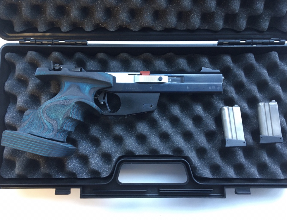

This is the one

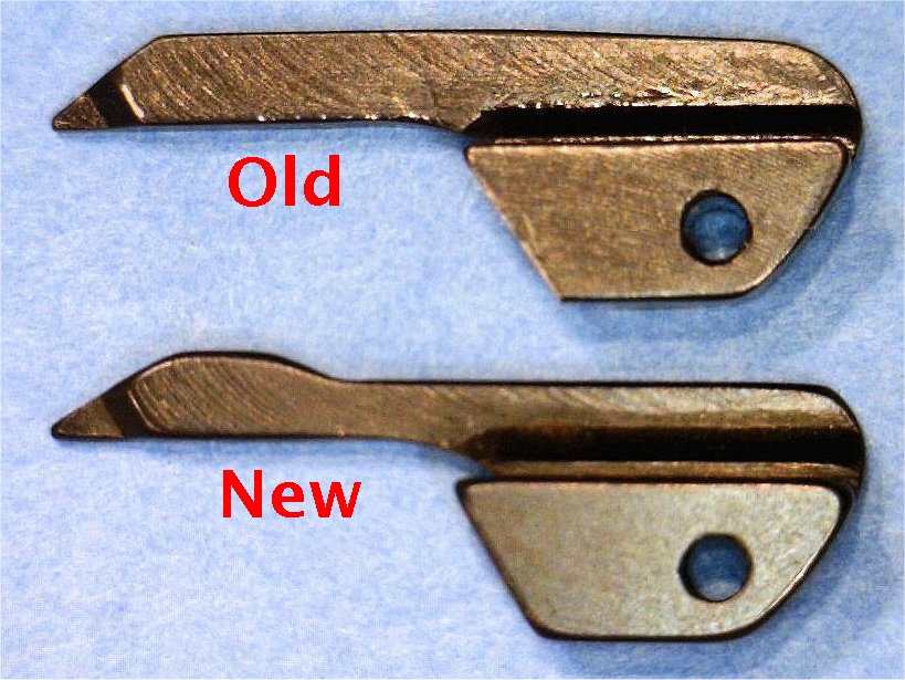

Re: Benelli mp90s trigger unit maintenance
Here is a photo that shows the two different disconnector levers:

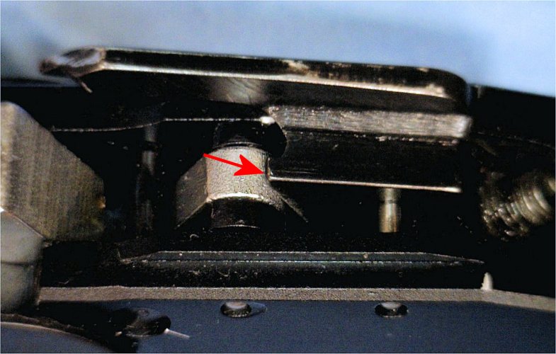

The maintenance & lubrication is pretty much the same. Some of them are a bit rough on top, and polishing them can also help reduce drag. The place you need to get grease is in between the bottom front of the lever and the rounded top of the chrome disconnector.
The levers are hand fitted to make sure that the pistol can fire when it's supposed to, without being able to fire if the bolt isn't closed far enough to prevent a case rupture (~ 1 mm gap or less). The fitting process may leave the under side of the lever a bit rough where it pushes down on the disconnector. You can feel how smooth the action of the lever is just by pushing it down a few times. You can lightly polish that area of the lever, but you don't want to remove any significant metal.

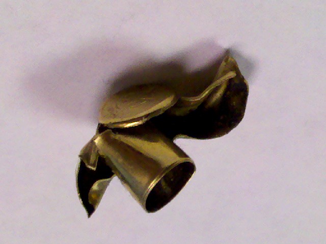

Just to illustrate the Gwhite's detailed explanation, this is how the case rupture due to not fully closed bolt of MP95e looks like:
Posts: 3566
I was actually surprised to discover that a large number of highly regarded European target pistols can do this. US pistols tend to have the disconnector set up so they can only fire when the slide is closed. Early Benellis, Pardinis and MatchGun MG2's can all fire "out of battery", and I think I heard that Hammerlis can do it as well.
This case looks like what I've experienced several times with my MG2. An ejection failure leaves a case in the action crosswise, but the next round is picked up by the bolt OK. The bolt closes with the round in the chamber, but is stopped by the sideways case so about 5 or 6 mm of the back of the next round is unsupported. As long as the extractor has a good grip, the hammer can hit the firing pin hard enough to fire the round. Kaboom!
It's rare in the Pardini (and relatively safe) because of the way the inner contour of the bolt surrounds the breech area. It's hard for a case to get stuck just right in that small space, and the bolt serves as a shroud to keep any brass bits from flying around. The MG2 is more open, and can trap brass easily if the ejector/extractor aren't set up right. The top cover helps to contain the blast, and I haven't had even a slight scratch from 4 or 5 kabooms. The Benelli is completely open on top, and they may have decided to fix the disconnector because of the increased risk of injury from shrapnel.
