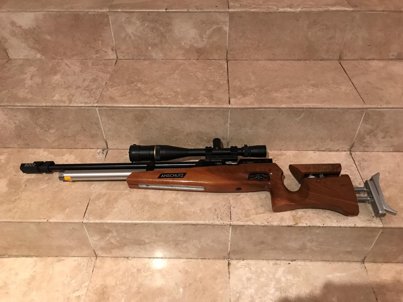

I'm new to the sport, me and my son eould like ti start shooting 10m air rifle for recreational porpuses, maybe he might get into competitions latter down the road, a friend of mine has offered me his Anschutz 8002 PCP air rifle for $750, I understand that this is an older model and perhaps I will need a new air cilinder (don't really know for sure) how donI know of I need a new one? The rifle does not come equiped with diopter sight nor a scope, is the price ok? I mean of I need to buy the sight and a new air cilinder does it still worth the $750?
I really would appreciate your comments

I forgot to mention that the scope mounted on the rifle in the picture is not included with the rifle
Re: Anschutz 8002 air rifle for beginer?
These ARE good rifles if well cared for. If the scope doesn't come with it, make sure the aperture sights are there, and if not, walk away...... The cylinders have a 10 year service life, and are probably out of date, but replacement would only be driven by condition, or how u feel about laws.......
Truthfully, you would probably be better served by a brand spanking new Crosman Challenger. It is a rifle capable of outshooting most people for less money, proper sights and a new cylinder come with it
Sights can be expensive, but for $750 I would say there is a fair amount of room for that extra expense, compared to purchasing another high end PCP target rifle.
Out of date cylinders are only an issue if you would like to use it in competition. For recreational shooting it is not a factor.
This is just my opinion, but based on what I've seen on the market recently, that is a pretty good deal on a good rifle. However, as spektr notes, there are less expensive options that would be adequate for your purpose, so it's up to you and what you want to spend.

I shoot an 8002 and like it a lot. If you buy it you will need sights. A 6834 sight set is over $300. A new air cylinder is over $200. Also you will need to fill you gun with air somehow. It's not a terrible deal but these are the other costs. Check Champions Choice website for prices as I think I am a bit light with my numbers.
Having said all of that an 8002 is a rifle you can compete with for way less than the current top end stuff and it is a dream to shoot.

On the surface a good deal but no sights is a problem. So whether it’s a good deal depends on how much $$ you have to spend on a sight set. I wouldn’t worry about the out of date cylinder. The out of date cylinder could keep you from shooting some of the bigger matches that check the date but from a functionality standpoint it’s fine. If you plan to buy that rifle, a site set, and a new air cylinder then I would pass and just buy a new rifle like a FWB Universal, Anschutz Club Rifle, etc.

Buy the rifle and then buy the sights elsewhere, that is a good deal for that 8002. I have seen 2002 go for more than that. Sights will stay with you as you progress, buy the best you can afford. You can buy used sights here, rimfire central or accurate shooter forum, but will have to wait to get a good deal. I sold a set of 7020 a few years ago for $375 shipped I believe, and I have seen the 6834 go as low as $200. There are usually cheaper older sights if you want something in a hurry. I think it comes with sights now, but a 9015 club is $2200 or so.

Just my opinion, the price is a little high considering it doesn't have a sight set and the air cylinder is out of date. If it came with sights and an unexpired cylinder, it would be good. But consider at minimum you'll need to spend an extra $200 for sights (older anschutz sight from ebay), an extra $220 - $250 for a new cylinder, and another $218 for a hand pump (hill from champions choice). Some say the cylinder would probably be OK, but for peace of mind, I would replace it. That's a minor cost vs a hospital bill or death. Has it been serviced or had seals replaced recently? That might be another cost you'll run into. If you want it, negotiate for some of the cost for these other items. If you get serious, you'll lose money if you want to resell the Anschutz and upgrade.
Another thing to consider is the age and size of your child. Will you and your child try to shoot off hand and kneeling? Or just prone or off a bench? The Anschutz 8002 is probably around 9lbs in weight. If you're just starting out and your child is still little, I would consider the lighter Crosman Challenger from Champions Choice. It's a pretty decent rifle and the sights that come with it are surprisingly good considering the price. The trigger is not comparable to an Anschutz, but is still pretty decent considering the price and good for a beginner to learn. For the price of Crosman Challenger and a pump, you're in less than the Anschutz.
