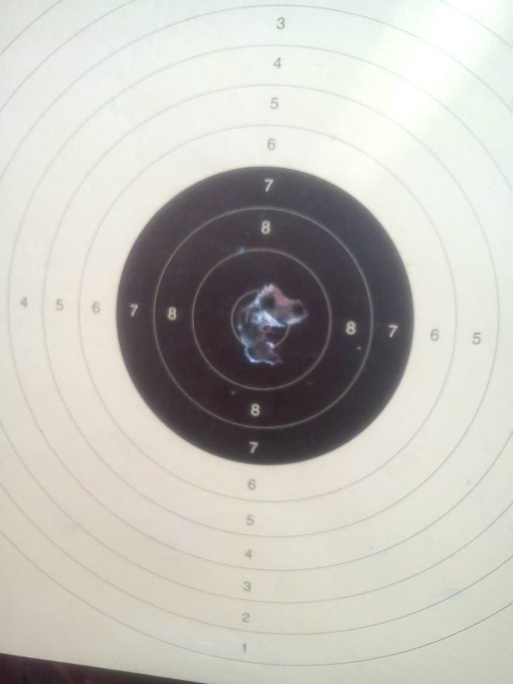

Re: Meisterkugeln Blue
I shoot this with RWS Meisterkugeln Blue Pistol offhand in training (with an expensive air pistol Lol ) . Picture tell everything
- rws blue.jpg (31.69 KiB) Viewed 3712 times
Yes, they tell us you are a better shooter than you are a photographer ;-)
By any standard, that must be considered an extremely good result.
