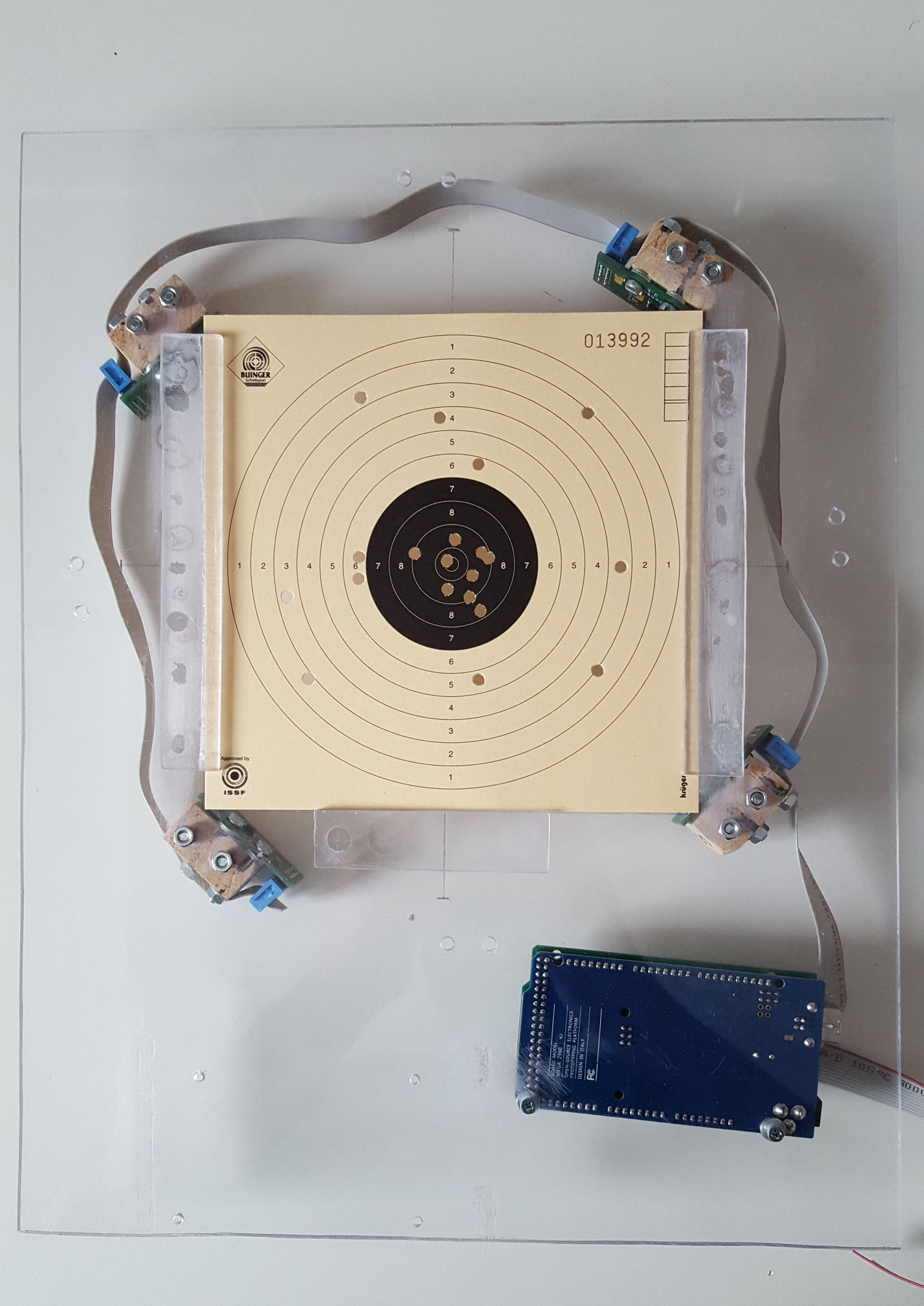

I'm in too. I'm a woodworker so making the boxes is easy-peasy. I'll order the harness within a few weeks.
I've been studying the drawings and would like to offer some constructive feedback.
You don't show the depth and location of holes. For example, on the arduino base, you show a 5mm hole but not how deep it is or where it is located. On the sensor mount, you show location and size, but not depth (are they through holes?).
What is the purpose of the target face guides and the wedges you call "target face"?

Posts: 451
Re: freETarget
the drawings were made by a third person involved in the project.
i think they are more like a visualization guide line - but yes, they are incomplete (work in progress). the sensor positioning in missing.
the guides on the target face are important to set the paper target - the system uses normal paper targets, not rolls like other ESTs. so the positioning of the target (and it's center) relative to the sensors behind is very important.
i, personally, have not yet used the system. i developed the software using a simulator. now i;m waiting for the electronic boards so i can setup the system at my home and test it.

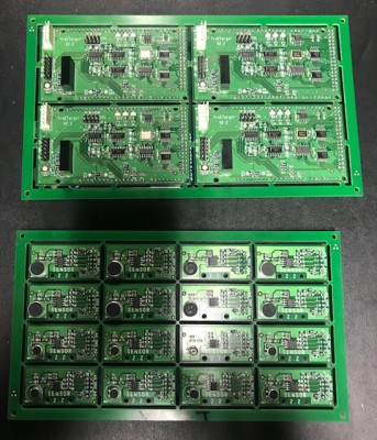

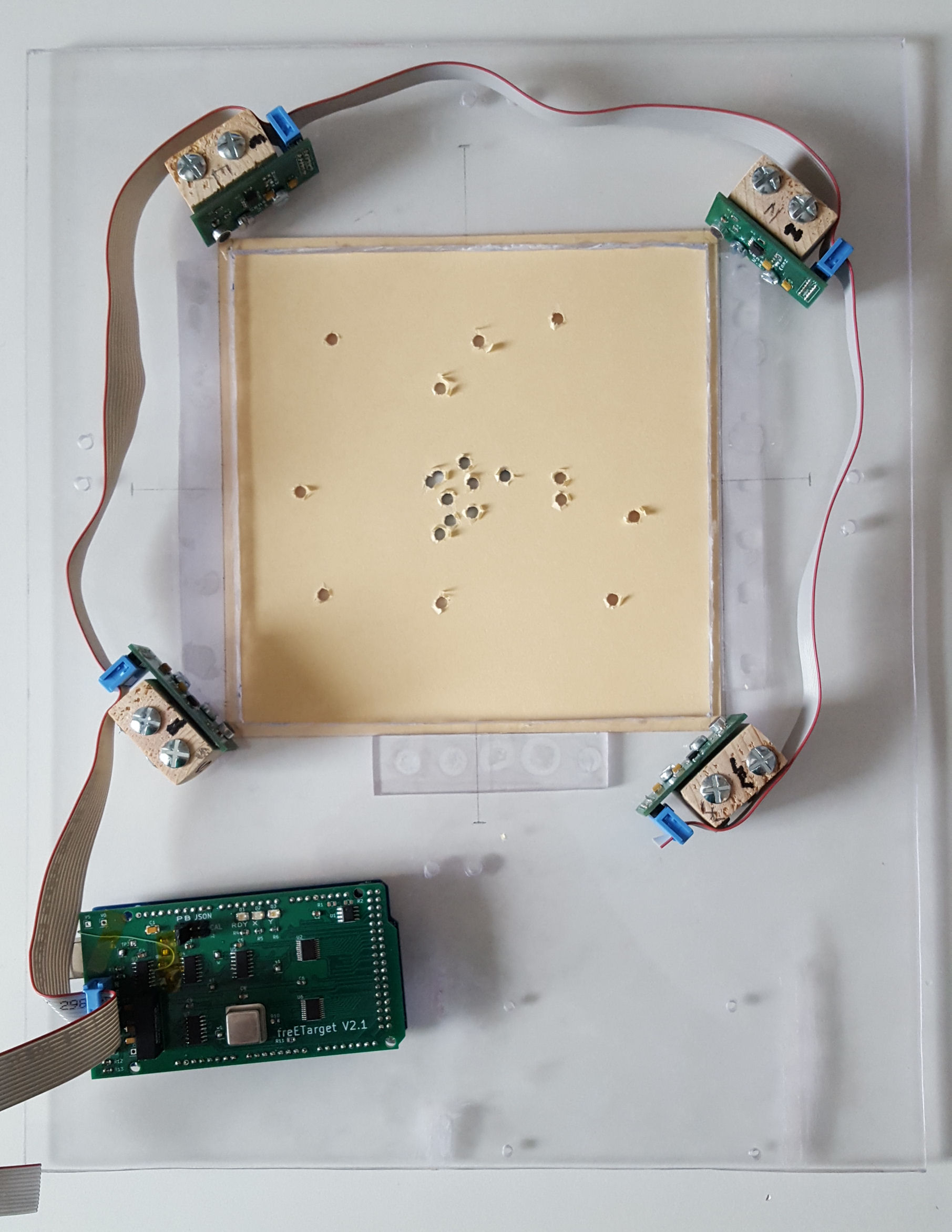

After months of waiting, the first 20 sample boards have arrived.
These are made from production tooling but still prototypes that still need some work.
If you want to try them out, go to the free-e-target.com web site and hit contact us. I will be shipping the first three this week to Colombia, Germany, and the US. After that it will be 2 per week until all the bugs have been worked out.
Production freETarget boards

I was up on your web site reading the theory of operation. It appears from that (I did not read in super detail) that the system has the resolution to discern to a tenth of a scoring ring for pistol. How about for rifle? Seems like it might not have the resolution for a tenth of a point in air rifle is that so?
Allan_KCMO
Posts: 3
Joined: Sat May 18, 2019 3:57 pm
Location: Kansas City
Re: freETarget
Post by Allan_KCMO »
In theory the timing circuit resolves to 0.125us, and since the speed of sound is 0.33mm/us at room temperature, the resolution is well under 1/10 of a point for a rifle.
