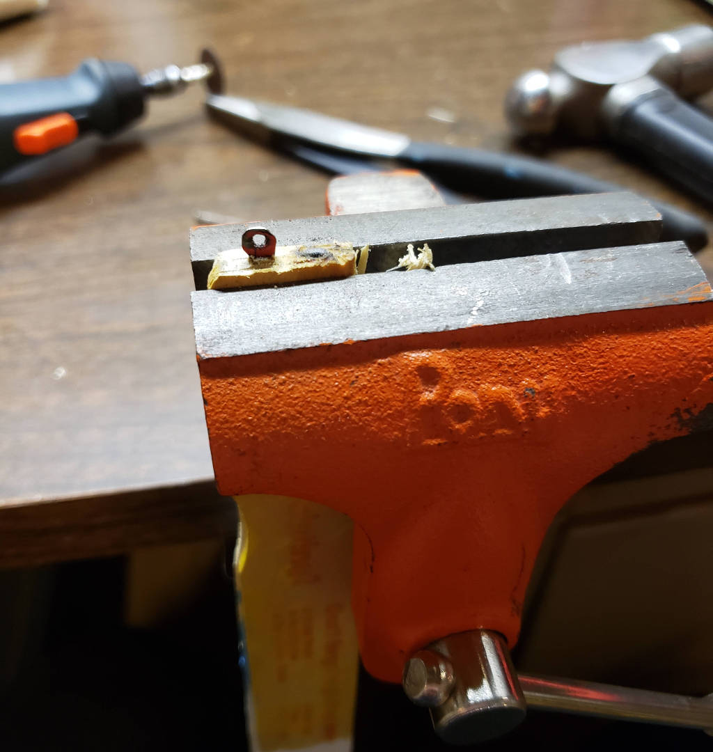

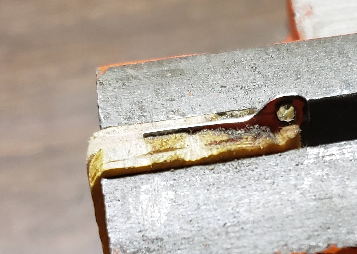

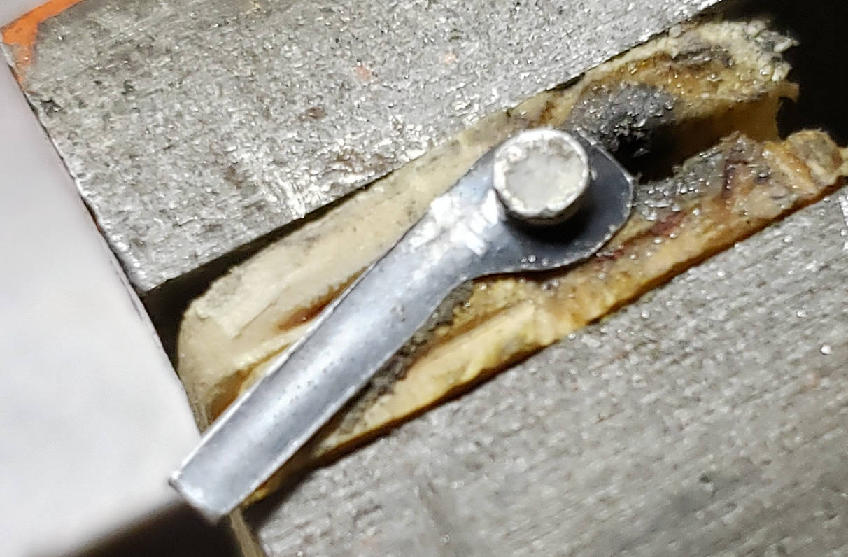

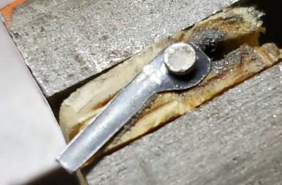

In case anyone comes across this thread in the future, I did manufacture a new spring out of a flat steel paperclip.
I got partway through the process before realizing I should take pictures to document it. So here's a few of the nearly-finished part.

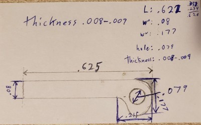

I measured the broken pieces of the original and drew out a (very rough) diagram
Took a couple of paint stirrers (nearest thin pieces of wood) and clamped them in my vise one against the other.
I clipped the paperclip over both of them, and attempted to drill through it. I then found my tiny drill bits were utter garbage and had the stiffness of a piece of spaghetti. (They actually unwound the spiral flutes, that's how bad the temper was). So I just drove a nail through the paperclip to punch the necessary hole. Clamping the nail between the pieces of wood held it firmly in place while I used the dremel and a cutoff wheel to cut away everything which wasn't in the rough shape of the spring I needed.
I then used files to remove everything else until I got to the shape I needed.
The spring does seem to work! Haven't done a live fire test yet, but it seems to work in dry fire.
