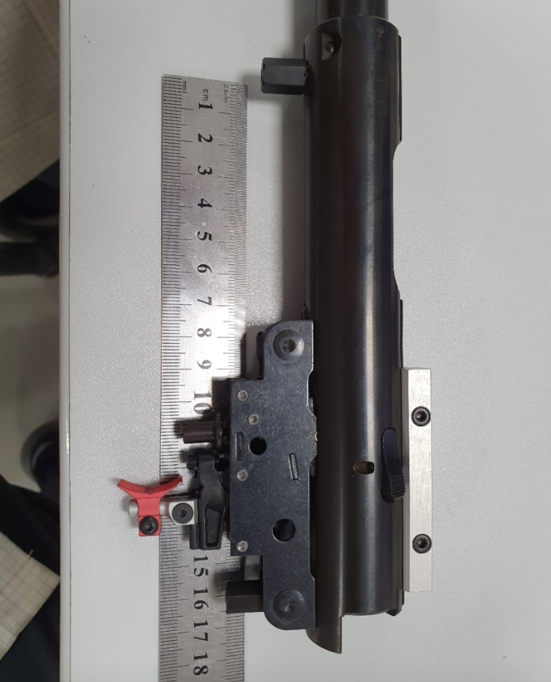

Re: Walther KKM-GX1 upgrade
See sttached the receiver size (mm)
I'm not sure that it fit well on the stock gap.
On the other hand there is a lack of drawings to check measurements and it is hard to invest 1500$ if you are not very sure.
Your idea of Robert's buttplate sounds very well. Do you have a sample?
Re: Walther KKM-GX! upgrade
Devi,
I'd remembered the Walter had a long trigger mechanism. If you are supporting the barrel, and the receiver does not touch the stock, it seems possible to make a bigger hole for the trigger. The new KK500 fits the EC stock, and that also has a long trigger.
Send me a PM with your email and I can send you pics of my Gemini buttplate. It is fitted to a Gemini stock. I'm sure I've seen one on a Walther GX-1 so it's just a question of drilling holes in the right places to bolt it onto your Walther.
