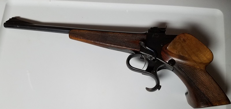

My oldest free pistol is 1935 Stotzer Original Perfekt chambered in .22LR. I'm still trying to find out if it was used in 1936 Olympics by one of the German team shooters.

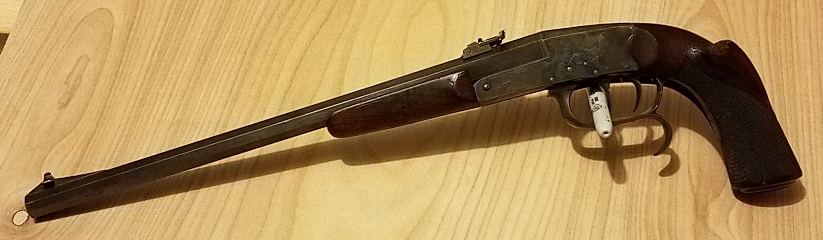

Wunder & Gunther, Leipzig. Probably turn of the century. Roughly 30 - 32 caliber, bottleneck case with the body diameter of a .38 Sp.
Might be an 8.15 x 24R. Not much info available on that. I think the chamber is deeper than 24mm. Otherwise, unknown so far. Slugs out somewhere around 308 to 312. Rifling is the classic flat bottom grooves and rounded lands.
Rim of a 38 needs to be thinned a fair bit to chamber. I've formed some cases with .223 and .32 dies, but making a proper one would be better. Need a seating die as well. And figure out a bullet, and what might be an equivalent load for blackpowder. One of these days.
Needs the sights to be widened 3 or 4x as well.
