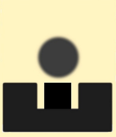

Depending on foresight width, light level, sight radius.
I adjust the depth of the rear sight so if forms a image as a square.
The eye likes symmetry.
sight picture 70%.jpg (12.32 KiB) Viewed 3146 times

David M wrote: Wed Jan 08, 2020 2:16 pm Depending on foresight width, light level, sight radius.
