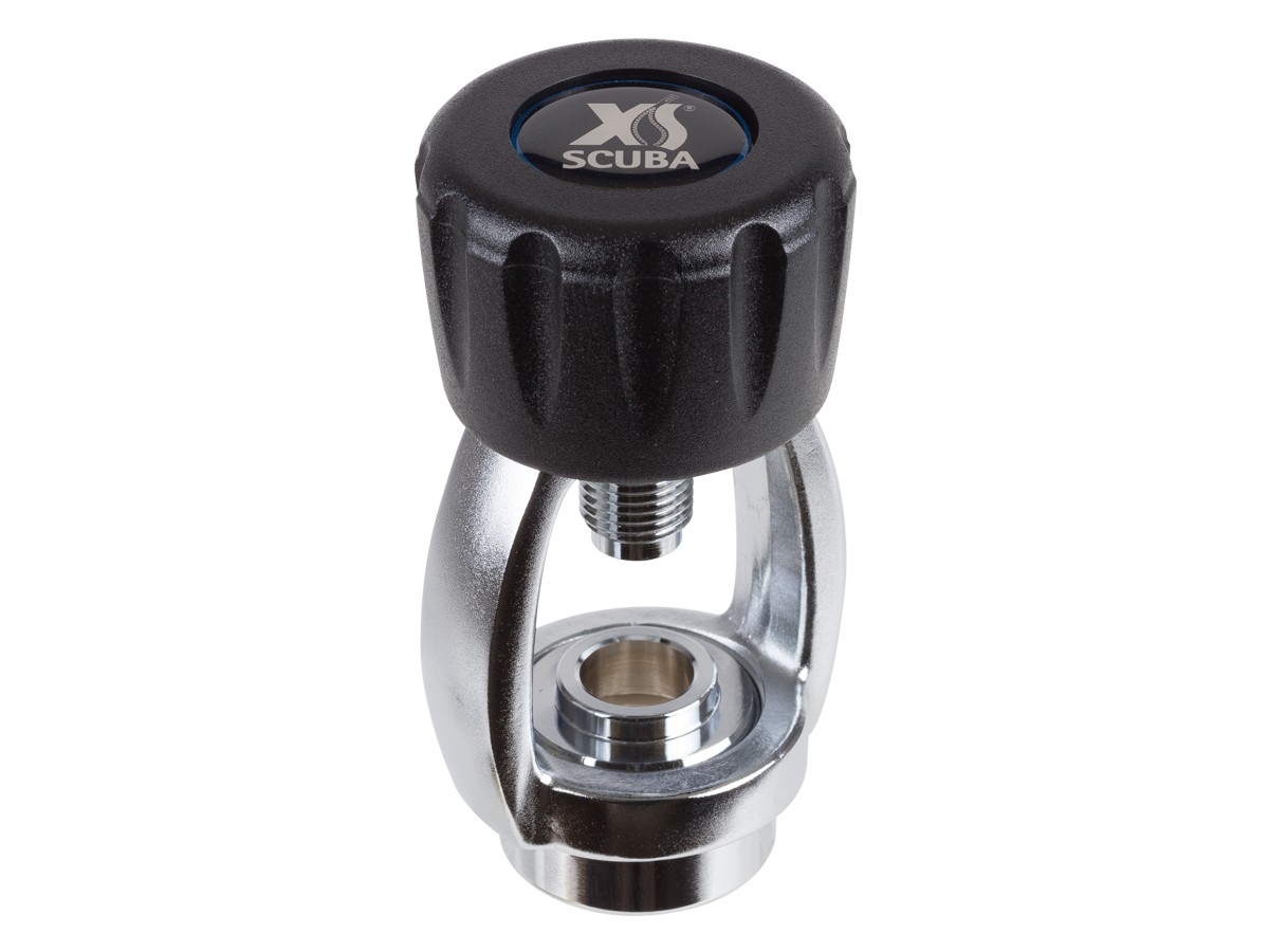

This is the adaptor I use. Your local dive shop should be able to order one in and if not you can order this one online.
https://www.ebay.ca/itm/MARES-Din-Yoke- ... 56c339ad3c
Hope that helps
Glenn

You need a k valve to female 200 bar din.
https://www.pyramydair.com/s/a/K_Valve_ ... apter/3973
