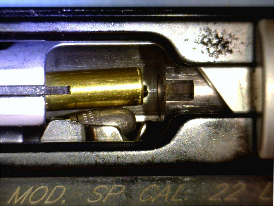

You can check this visually if you have proper dummy rounds (not aluminum or plastic dry fire rounds), or at the range with a live round. Insert a fired case into the chamber, and close the bolt. Then insert a magazine with 1 dummy round. SLOWLY pull the slide back just until you see the case begin to deflect upward & sideways when it hits the ejection tab on the magazine. Ideally, it should never touch the nose of the dummy round. The pistol will also still work OK if it just touches, but doesn't get deflected significantly.
Here's a picture of this test on my wife's pistol when she started having problems with a particular magazine:
You can see that the fired case is being deflected quite a bit. Here's the same test, after a thorough cleaning of the magazine:

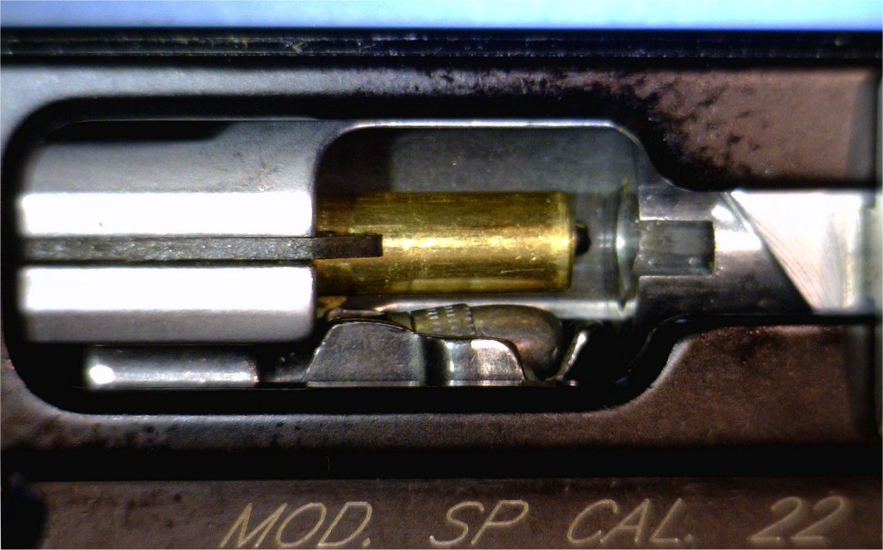

Now, the fired case is no where near the 5th round.

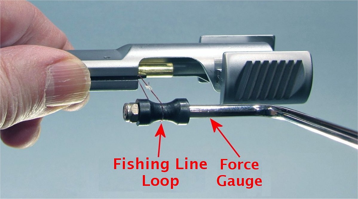

3) Extractor force: If you have some sort of trigger pull gauge like a spring scale or a Lyman digital gauge, you can use it to measure the extractor force. Depending on the gap under the extractor hook, you need some thin strong fishing line tied in a small loop. Hook the loop under the extractor, and clip a fired case onto the bolt face, fully seated to the rear. Then pull sideways with the gauge until the case drops. A well fitting extractor and a fresh spring should give readings around 2 pounds or more.
If it's much less than 2 pounds, you probably need a new extractor spring.

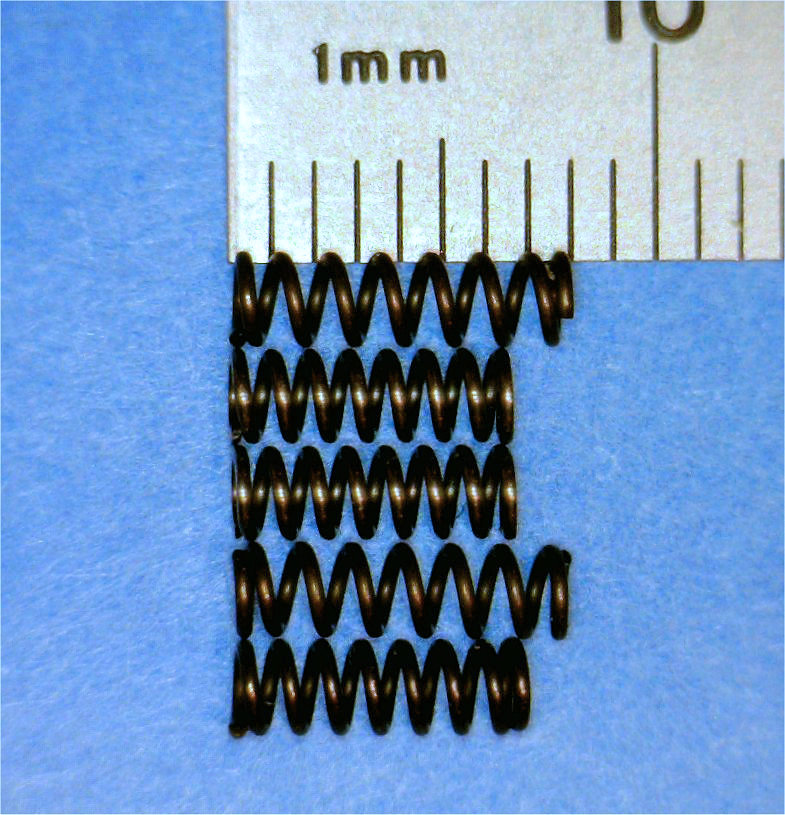

Pardini extractor springs can vary quite a bit. I think the newest ones are a good bit stronger than older ones. Here's a photo of several different new ones I had in my stash:
Some have ground ends (which I prefer), and some do not. Some are noticeably longer than others. I think Pardini USA ran out a while back, so they should have the newest design back in stock now.
