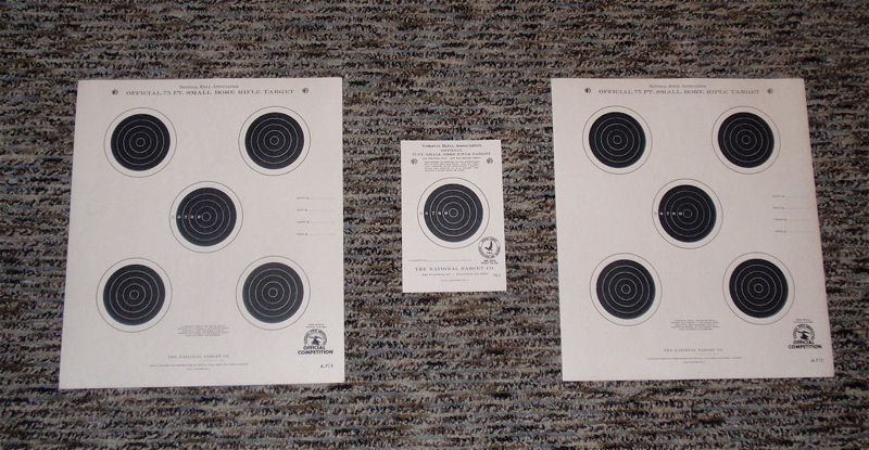

The target that you need for 25 yd/75 ft is the A-7/5, available from Kruger USA or Pistoleer.com. I'd recommend the Kruger's as they're printed on better paper, IMHO, and the bullet cuts a more uniform hole. For competition purposes, two shots for record are placed on each bull. A separate, single bull, is used for your sighters.
Here's a link - Here's a link - https://www.kruger-us-targets.com/index ... a-7-5.html.
Our club here in eastern PA runs an indoor winter match series shot at 75 ft. Kind of an oddball distance, but challenging nonetheless.

I've attached a pic showing the basic layout of the targets for our match (which is prone, BTW). The single bull located in the center is used for your unlimited sighters. Your shots for record are placed on the left and right targets, two shots per bull. So, for each stage of the match, you'd be shooting a total of 20 shots for record. Our match has four stages, so the total is 80 shots for record, or an 800 aggregate.
If you can't practice prone for now, that's okay. If nothing else, having the correct target will allow you to get in the ballpark, at least, with your aperture size on your sights, which really won't change too much as you move to 50 ft, or 50 & 100 yds. The bull diameter is proportional to distance, so it appears at least similar as distance varies. You'll probably have to tweak your settings somewhat, however, for changing lighting and atmospheric conditions.
Hope this helps!

It is very helpful. Thank you so much. I think I might just start with standing. What the heck. I have been a Taichi teacher for over 15 years. I should at least have my balance. I will then work down to prone while Cardinal center is being built ready for the Nationals for the July 4 weekend.

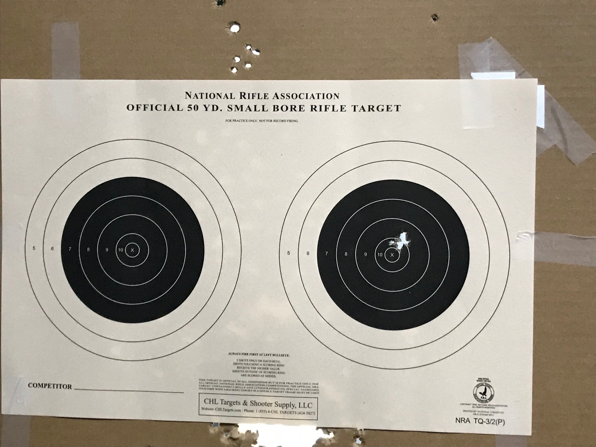

Straight out of the box I made some shots at 50 feet. I am attaching a picture. The group is high and right. I turned torrents 6-8 clicks on both and saw very little change. It did increase my group. It was late and I did not have much time to shoot more last night. Will do it again this weekend.
So can you walk me through a basic sighting process given my lane is 75 feet max? For this group in my picture, how should I adjustment my torrents? Turning clockwise on both elevation and windage, right?
